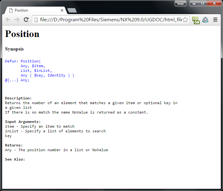

Let's assume I have a list of some string values. It is possible to use nth function to obtain value at given position.
Does a out-of-the-box function exist to solve a reverse task - to obtain position of a given value? For example, to obtain 2 if "Trim 2" is given.

There is a function for this... With a big caveat. smile
There's an OOTB function called [maybe not surprisingly] "position" that does this:
In my model I'd manually locked this particular formula to prevent inadvertent edits, hence the blue and the lock. Just ignore that here.
The caveat here is that If the string (or number) you're using for the search is not in the list, then this function does not fail particularly gracefully. You'll want to make very sure that your input matches one of your options. Play around with it, and you'll see what I mean.

Just tried and discovered that I have no access to this function OOTB. Either it appeared only in NX11 (I tried in 8.5 and 10), or you have customized your NX to have it and forgot about it! :)

I'm running NX 9.0.3.4 and it works for me, I'm surprised it didn't work in NX 10 for you.
Here's an expanded version that fails gracefully if the item is not found in the list (it will return -1 as the position).
CODE
IF (member( MATERIAL_STRING_INPUT, MATERIAL_LIST_NAMES, "key", Identity, "test", Equal ))(Position(MATERIAL_STRING_INPUT, MATERIAL_LIST_NAMES))else(-1)

Really should be OOTB, I found a documentation for it.
Why none of my NX versions has it I have no idea! Maybe some obscure enviroment variable has to be set?

It does not show up in my list of functions either. There are some KF functions that can be used with the expression system, this must be one. It seems Taylor let us in on a little secret.
Edit:
Quote (PrintScaffold)
Why none of my NX versions has it I have no idea! Maybe some obscure environment variable has to be set?
Just type it in and use it, no environment variables need to be set first.

That is the reason I thought I was missing it! Turned out that I have it and it works. Thank you!

When I first discovered this function a few years ago, I was told that while it works as advertised, it was not considered to be 'officially' supported due to that 'failure' issue Taylor mentioned earlier. I would hope that there are plans to fix that as this is a very useful function to have particularly if you would like to use sets of List Expressions as a sort 'flat' data base.

All of the Knowledge Fusion (KF) functions are "functional" within the Expressions environment, because KF is the primary engine making Expressions work.
Back in about NX 3, we selected a subset of the full KF language and identified these functions as "DesignLogic" functions that would be visible to interactive (as opposed to programmatic) users of NX within the Expressions dialog. Initially, this subset was selected mostly because they would return a single numerical result, back in the days when NX Expressions could only store single floating point numerical values. Of course, in subsequent versions of NX, we've expanded the set of supported datatypes for Expressions and at the same time expanded support for a larger subset of the body of KF functions that are visible in the Expressions dialog.
But if you know what you're doing, there's no license preventing you from using other KF functions in Expressions. The source code for all of these KF functions is available in the NX installation, so they're not particularly secret. But be aware that once you step outside that "DesignLogic" set, things get a bit trickier, and as cowski has done above, some additional error handling may become necessary.
