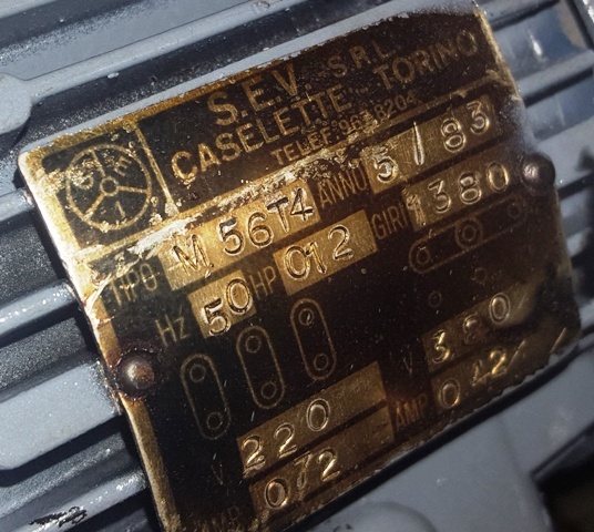

Hi, I've come across a strange problem with a couple the tiny (0.089kw/0.12hp) motors at work.
Both motors are identical. We run them on 220V 50hz. According to the name plate they should draw 0.72A, but they don't. Even without a load one draws 1A and the other 1.2A. To make things more fun the name plate shows a 6 wire connection, but there is 12 wires that come out of the motor. I'm not sure how long they have been doing this for as we are only fitting them with overloads now. Both motors are connected in wye wye.
The motor that draws 1A has just been rewound (low insulation resistance), but i didn't think to check the current before it was sent away.
I tried a few different connection options for the motor drawing 1.2A (wye wye, DELTA, and delta delta) but the current only got higher.
I've considered that the windings could be polarised incorrectly, but since one has just been rewound and the other has been checked by our rewinder I don't think that is very likey.
We might have some other motors that are identical, but the machines need to be turned over to see the motor so I can't confirm that right now. And yes these motors do have a terrible power factor (0.32 by my calculation)
Anyone have any ideas as to what the problem could be?

The nameplate shows Star Delta connection.
RE: 3 phase motor problem
on your 1st post you said that the motors are connected 220V wye
but on the nameplate shows the it must be connected in delta to 220V ... ponder

Your motor windings are not getting enough voltage because you got your motor connection wrong. Wire the motors in delta and supply with 220VAC or wire your motor in wye and supply with 380V.
Seems that the motors have been rewound in the past, but whoever did it changed the winding setup. It's the only way to explain why they are 12 wore not 6, and why the windings differ from motor to motor.
