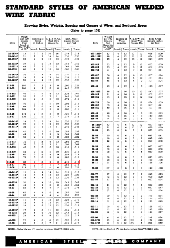

I am working on a project that the record plans show "316-28 WWM" for a 6" thick slab reinforcement. I assume it is probably a stainless steel wire mesh. Does anybody know how I could get the design info for it?

Also, American Steel and Wire Co. catalog of early 1900 has the 316-28 as a noted Wire Wire Fabric STYLE, as follows:
Let me see if I can dig up the STYLE details from my reference and post details here.

So digging 'deeper':
1. "316" is longitudinal wires at 3" c/c, transverse wires at 16" c/c.
2. "28" is #2 gauge wire longitudinal, and #8 gauge wire transverse.
So total it all together and you get: "316-28" = #2 gauge longitudinal wires at 3" c/c, #8 gauge transverse wires at 16" c/c.
For reference: #2 gauge is 0.2625" dia. and #8 gauge is 0.1620" dia.
REF: American Welded Wire Fabric by American Steel and Wire Co.
RE: Need Old WWM Properties
Thank you Ingenuity. This really makes sense now because, according to the plans, the 6" thick floor (one way slab) was designed for 200 psf of LL.

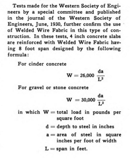

Interesting equations in the same reference:
Assuming 8' spans, 3" average to depth of steel, with stone/gravel concrete, this equation gives you a 303 psf TOTAL load capacity.
