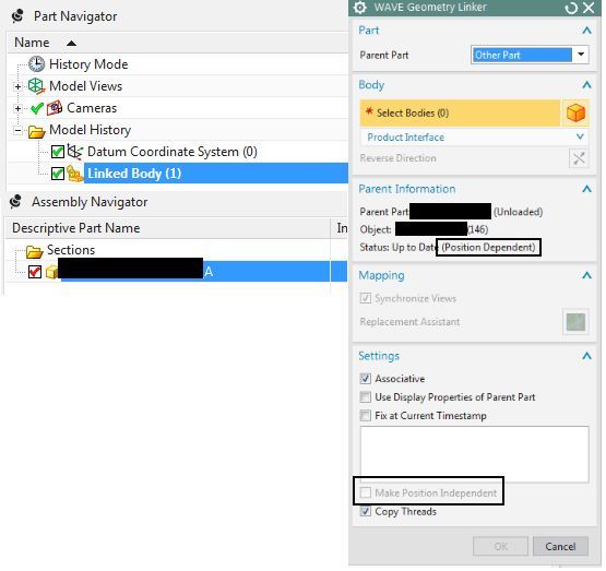

Dear All!
I apologize for my silly questions, but I need a hint once again.
Today I've found a part, which has a linked body within. It's not a PILO, but position dependent object which is referenced to a part i don't have.
The main issue is that WAVE-copy remains active (not broken) despite the fact, that it is position dependent and parent part is not loaded and not included in the assembly. This WAVE-link should be broken due to this logic. There are some pics:
www.CADabout.ru
RE: NX WAVE links behaviour
Check your assembly load options; there is a "load interpart data" option in the "scope" section of the dialog. If this option is turned on and the link parent can be found with the defined load options, the link will stay unbroken.
www.nxjournaling.com
@cowski
This option is turned off. Besides, there are no chances that this part can be loaded any other way, I simply never had it on my computer (we're not use TC).
www.CADabout.ru
@Lockdain
In my experience with WAVE Linking, the best way for the link to be unbroken is to create a link like so.
Let's say you want Part A to be linked to Part B. Create an assembly, lets call it Assembly C and assemble Part A and a blank Part B file into the assembly. Since you do not have the WAVE license leave the position dependent. Create the WAVE link within the assembly linking Part A's geometry into Part B. Save Part B once the link is generated but do not save the assembly (you can if you like but it is not necessary). Close everything out and you will see that the link will remain unbroken between Part A and B. If you make a change to Part A, Part B will update so long as Part A is open in an active window. If you open Part B and the part is not updated, it will update as soon as you load Part A into an active session.
The reason the link remained unbroken in your instance is because the WAVE link was created this way. Any changes to that part will not update in the WAVE link because you cannot load the part since it has never existed on your machine.
I hope this helps. I am just learning this as well and tested my theory and it seemed to work for me.
Jarrett
