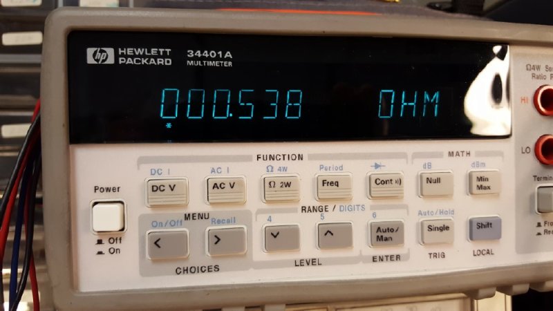

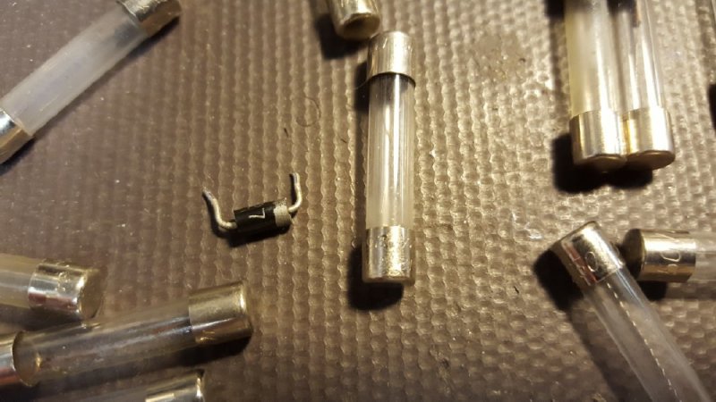

I studied all the caps in supply B against all the caps in A and all the transistors with all the transistors. Using the diode mode I checked all the diodes. D202... Shorted. That'll load the fuse up nicely.
So I pulled it:
And this is what I get measuring it with a Diode Test (Forward Voltage Drop) a whopping 0.00058V. It's the same with either polarity!
And of course measuring it with an ohmmeter:
It appears Heath Kit in an effort to hide its designs from competitors had everything marked with their own codes so I can't see what diode that really is. I stuffed a 1N4007 in and called it a day. A 1N4007 is a little smaller than the one I pulled so it may fail sooner than later but I left long leads on it to help cool it.

According to the manual, D202 should be a 1N4002 (1A, 100VR). You replaced it with a 1N4007 (1A, 1000VR) You should be good to go for another 20 years...
