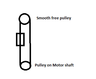

Hello,
Suppose this pulley is latched to a motor's shaft residing on the floor. On the ceiling there is a similar pulley hanged on a hook. At the center of the belt's height there is an object carried by the belt. When I ran the motor sometimes the belt's teeth does not lay on the pulley's groove which causes the object's position to not be coherent with the motor's rotation. I tightened the belt and the problem still comes from time to time? The motor is moving forward and backward.
is there any idea how to solve this problem?

Hi John,
Here is a drawing.

What is keeping the belt in contact with the "object". What is the object? We cannot guess.
STF

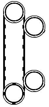

how about using outer idlers to keep prevent oscilations in the belt causing it to jump a tooth.
RE: Belt and Pulley
Hi Byrdj,
Thanks it's a good idea.
I added the bottom roller only, where the motor pulley. But I did not add the top one. By the way the upper pulley
has no teeth, it's a roller. But the motor pulley still skips the belt teeth sometimes and as soon as start skipping it stays doing it.

Hi SparWeb,
The object is a trolley. Both belt ends are fasten on the trolley. The trolley carries 10-20 lb rod.

Perhaps you need two outside idlers at the bottom - one each side of the motor pulley. There are really only two possibilities for your failures:
1. Belt oscillation during rapid travel is allowing a "slack" wave to ride around the motor pulley.
2. The belt is under-rated for the loading applied.
Either way, two idlers at the drive pulley will help by increasing wrap angle on the drive and isolating it from oscillations.

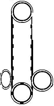

Tooth jumping is a common problem on long belts. You have to use idler pulleys on the back side of the belt near to the toothed sprocket.

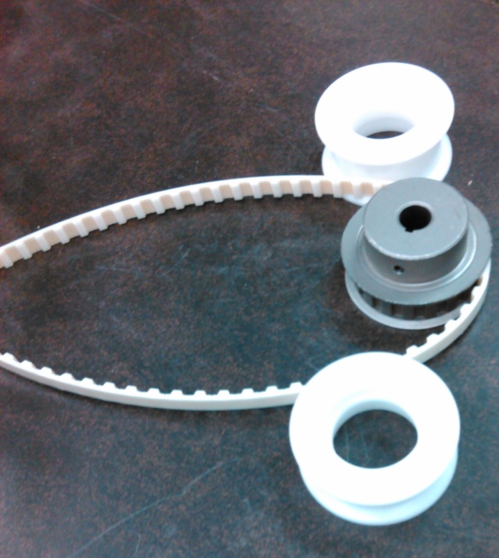

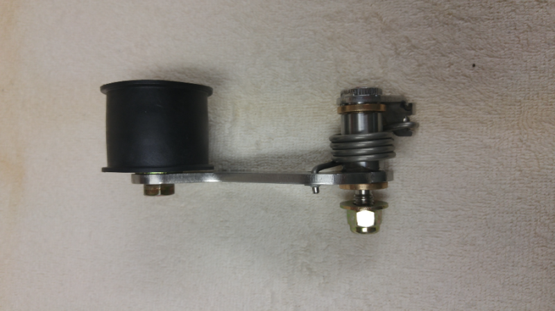

Hi All,
We tightened the belt but from time to time the belt slips and causes a displacement to the trolley.
The pulley is on the motor shaft . On the other end of the belt is a roller. The two rollers near the
pulley to guide the belt and forbid the belt vibration. Any idea how to stop completely the belt slipping.
I attached a picture for the material.
-Omar
RE: Belt and Pulley
We need a picture of the installation, not the loose parts.
RE: Belt and Pulley
Hi 3DDave,
The installation looks like the picture in the previous post.

A diagram isn't the same as a photo of the installation.

RE: Belt and Pulley

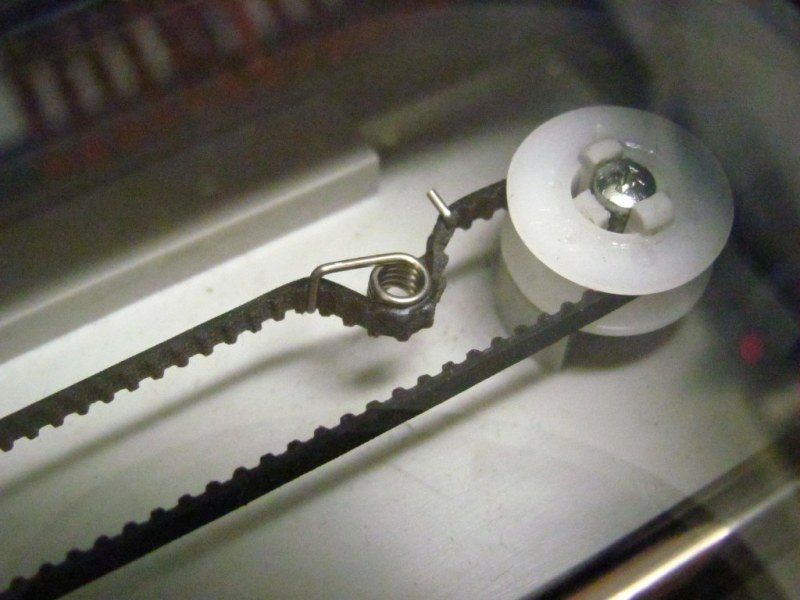

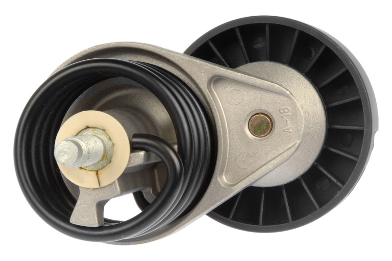

I would, as suggested above, use a stiff spring under tension to mount the top pulley. Or alternatively use a torsional spring forcing an idler pulley against the back of the belt at the top to keep the belt tensioned during the accelerations.
