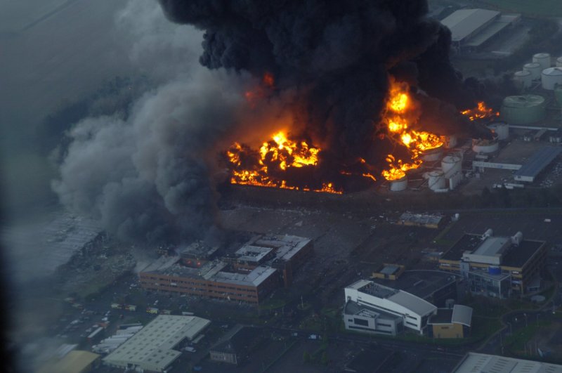

I'm sure this has been reported on previously and there have been two voluminous reports issued.
However the root causes, both technical and in particular the serious safety management failings were not included due to ongoing criminal prosecutions in the UK. I think this was originally published in Feb 2011 after the cases concluded, but I didn't see it at that time. If this has been examined before, my apologies, but it's never too late to make a reminder for us all.
Whilst looking for something else, I came across the following http://www.hse.gov.uk/comah/buncefield/buncefield-...
Along with the Longford explosion in the Australia and Texas City, Buncefield showed yet again, that safety failings of management are a root cause of such incidents and still continue.
The report makes interesting reading both from a technical view and the management failings. The ultimate line of defence - the independent high level switch, needed a padlock to keep it in its operating condition and should only have been removed for test purposes. Unfortunately the manufacturers neglected to tell the installers and operators this and they thought it was the opposite or only for "security". Hence the padlock was never used and the switch was effectively disabled.
The tank gauges stuck on regular basis, but were just fixed as an ongoing issue which wasn't logged or reported, etc etc. Everyone was overworked, throughput was 4 times the original design and handover time from one supervisor to another was actually in their own time (!!). The supervisors had got used to big overtime cheques so resisted recruitment of another supervisor.
Most shocking for me was that the supervisors had no control over their incoming flow from other pipelines, no ESD button, no contact with the schedulers, no apparent contact with the upstream control rooms. One of my golden rules in design of pipeline systems is that the incoming recipient of product needs to have full independent control over the incoming systems not dependant on any other party.
The company officially operating the site was in essence a "shell" company which had a board (who met twice a year), but no employees and delegated all actions to the operating company.
All sounds too familiar?
Well worth 30 minutes reading IMHO.

The problem / issue I see many times is that "safety", especially in operating plants, has had a distinct tendency to become "personnel" safety - trips, spills, falls, PPE, that sort of thing rather than "process" safety which is really what this incident ( actually HUGE conflagration) was all about.
The operations staff were simply concerned with keeping things running and not whether the process was correct, or safe.
The apparent reported lack of clear operating procedures and instructions is nothing short of criminal and I'm a little surprised they didn't find some senior person who should have been responsible for ensuring that these were in place. That might have promoted a bit more of a discussion about how the place was supposed to operate as to how they did it in practice and point out the shortfalls - in short a proper audit worth its proper name.
Lets not forget how big this fire was....

I suppose this reflects a little the miracle that no one was actually killed or, I believe, seriously injured, though many living locally still suffer mentally and I think they ended up with a big fight for adequate compensation.
Also perhaps some recognition that the companies had lost a significant amount of profit and lost a lot of capital equipment.
However a fine for the main companies of £50M wouldn't have been incorrect IMHO. Would make others look very seriously at doing things properly.
In the end unfortunately, only a serious dip in share price has any big impact - BP is still under the cosh now from the result of deepwater horizon and it is now appreciated in oil companies that a serious incident can impact company reputation and share price.
