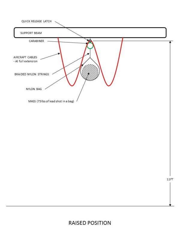

Mass (load) will be at rest in the air, s0 = 11 feet above the ground
Mass will be released in free fall and accelerate due to gravity until the cables are extended, just prior to the strings starting to stretch, s1 = -6 feet which is 5ft above ground
Mass decelerates when there is initial tension on the cables to its full extension point with the strings stretched to their max point, delta s = -0.833 ft which is
- cables are acting as an arrestor
- this stretch is due to the elasticity of the 4 load strings, not the cables
- the mass is held inside of a nylon bag with 4 strings, the strings are attached to the quick release latch that is 11 feet in the air
Mass has negligible deformation because it does not impact any object
- after 2-3 rebounds of decaying height the final position is sf = 5 feet above the ground
I assume peak load to be at the point when the mass has completed its free fall and deceleration, which would be -6ft of free fall plus -0.833 of elastic deformation of the load strings (11ft -6ft - 0.833ft = 4.167ft above the ground). This is the static load equivalent that I am looking for so that I can determine the correct size of structural steel or tubing to mount the cables for this "drop test"

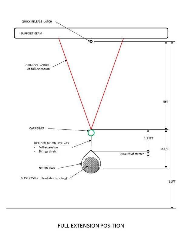

The cables do not stretch. It is the 4 braided nylon load strings and the nylon bag that is holding the mass that stretches.
The full extension position of the load is 0.833ft below the 6ft extension... 6.833ft below the 11ft starting height or 4.167ft (5ft - 0.833ft) above the ground. I've attached some crude sketches ... not to scale ... of the 4 positions of the test, reference image 3.
77JQX,
Just so I understand ... 1230lbs of force for both cables (615lbs x 2 cables) at the max load, i.e., when the 75lb mass has reached the full extension shown in image 3
Thanks for all the input and feedback so far!!

so the mass starts to fall, the cables unravel (without load).
then the cables deploy to full length, with the mass travelling due to free fall.
then the braided nylon strings the fall (cables assumed rigid), and the mass stops falling shortly afterwards.
it sounds like you're trying to subject the contents of the bag to a finite acceleration ?
it would've been nice to start with the picture ... much clearer.

The cables are 3ft apart, or each cable is 1.5ft from vertical (my apologies, should have included this in the sketches).
This gives an angle of approximately 14° between vertical and the actual force vector of 545 lbs.
If I have calculated correctly, this would yield a vertical vector of approximately 561.7 lbs for each cable and total of 1123.4 lbs.
Does this sound correct?
