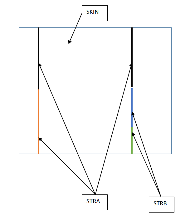

Let me try to explain my issue again with help of an image.
The stiffened panel is made of 3 parts: Skin, STRA (Str Type A) & STRB (Str Type B).
As can be seen in the assembly, STRA is repeated thrice and STRB is repeated twice. Catia V5 denotes each instance of the part as STRA.01, STRA.02 in the CATProduct module.
When I import the part (Catproduct) in to Abaqus and if I chose the option the option "Create Individual Parts", Abaqus creates a part for each instance present in Catia v5. Is there any way to tell Abaqus that STRA01, STRA02 etc are of the same part without having to reassemble them in Abaqus Assembly Container?
I have to extract surfaces for shell modeling and it is tedious to do that for each part in Abaqus. The intent is to have it done for one part and hopefully it will translate in to other parts automatically. Similar thing with meshing...can mesh one part and it will be reflected on all other similar parts!

Instances in CAD are always translated into parts during import in A/CAE. I don't know why. Probably a limitation in the information that are available during transfer.
You could create the midsurfaces in CATIA, so they are also transferred to A/CAE.
Otherwise create a second/third instance of the first part, position it on the one that becomes reduntant and then delete/supress that reduntant instance.
So create a second instance of one STRA part and position it onto the other. Then delete the redundant one. Repeat if necessary.
