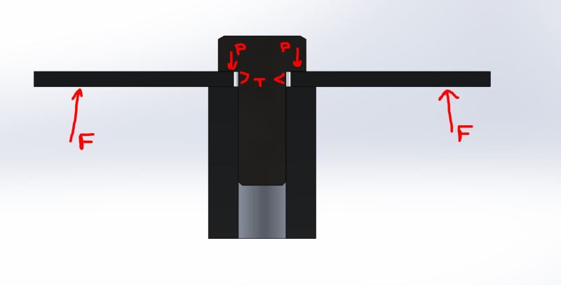

So I threw together a rough model of what I'm looking at. What I'm trying to look at is how much tension 'T' is in the bolt. We have a force due to preload 'P' and then an alternating force 'F'. Based on my observations, I'd feel like the tension would be P+F. So my mean stress component would include both P and F while the alternating component would only be F. But looking at it this way yields unrealistic results.

Hi kDiqq
The tension the bolt will see if it's preloaded correctly is its preload + (kb/(kb+kj))*F.
The kb and kj are the bolt and joint stiffness respectively, with F being the externally applied load.
How the joint works is when the preload is applied to the joint; the joint faces compress slightly generating a compressive stress and a compressive strain, conversely the bolt is tensioned and under goes a tensile stress and tensile strain.
If you now apply a external load trying to separate the joint,what happensis is that some of external force is used up in reducing the initial compressive stress generated by the preload and consequently reducing the compressive strain. In order for this to happen the bolt or screw must elongate by the same amount as the joint faces did when the compressive stress is reduced by the external load.
In order to find the fluctuating force in the bolt you have to estimate the bolt and joint stiffness as indicated in the previous paragraph. The link below might help:-
http://portal.ku.edu.tr/~cbasdogan/Courses/MDesign...

desertfox,
Thank you for the information. I still have the problem of my mean stress component being very high while the alternating component ( (kb/(kb+kj))*F in this case ) is very low. Not so much an issue except the fact that the mean component causes me to get unrealistic results (something like 1.5 cycles). How do I consider the stress due to preload when using an S-N diagram to estimate life?
RE: Fatigue on a threaded bolt
If your mean stress is too high, the bolted connection needs to be fitted with stronger bolts (increaed diameter, higher strength or more bolts) Again VDI 2230 gives you a straightforward recipie for this.
Hi
The mean stress isn't a problem the fatigue stress in the bolt should only be considered on the cycling stress unless your cycling stress when added to the preload of the bolt takes it beyond the elastic limit, in the latter case then as izax1 stated you need to alter your joint.

Hi
In order for you to do a fatigue calculation on the bolt you need the proportion of the external load seen by the bolt during operation, the mean stress is the minimum stress (in this case your bolt preload)which then should be added to the maximum stress the bolt sees in operation ( the proportion of the load due to bolt stiffness) and finally divided by two. The alternating stress is the difference between the above two stress figures divided by two.
