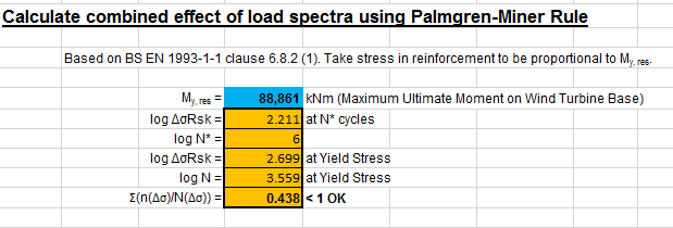

No I was not sure how to find the stresses on the bars. I reckon the stress = maximum tension over the reinforcement area which is 1800000/ 8* (3.14* 12^2/4)= 200 MPa

Yield stress 500 MPa

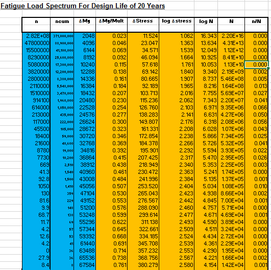

Please find my attached excelsheet calcs
RE: Fatigue spectra
nothing there looks scary ! it looks like 70MPa is stress for infinite life. I think you're ok exceeding it.
Is your design life (20years) meant to be a safe life ? If so, I think your design is marginal (typical safe life factor = 5, so miner's rule damage sum is 0.2, and I think you're a little over that ... maybe safe life factor =4 ?).

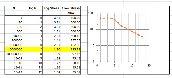

I am not sure how you managed to determine the safe life factor? please if you don't mind to explain in details. I am a bit confused fatigue loads damage cycles equal 1,00 E+7, should the allowable stress be 125.82 MPa or shall I use 162.5 MPa because the ΔσRsk for straight and bent bars = 162.5 MPa

use bent bar stresses if the bars are bent !
the previous table looked like a simple cumulative damage table, so I can sum the few numbers to get something like 0.3 by observation. Safe life factor divides into the allowable (sum damage < 1/n) so I figured a safe life factor of 5 wouldn't work, maybe a factor of 3 would.

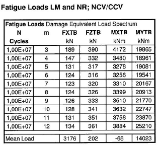

I don't understand your table "fatigue loads LM and NR", or your term "deltasigmaRsk".
The S/N curve looks reasonable. Your Miners rule calc is good-ish (I don't see why you'd do a fatigue calc for ultimate load), but don't you apply a safe life factor?

That table load spectrum is the fatigue loads from normal turbine production. For the structural design of the reinforced concrete components of the foundation, the mean value of the load components have to be taken into consideration. The given fatigue load spectra represents fatigue loads for a design life of 20 years.
