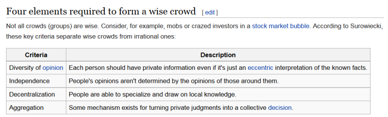

One way to arrive at a reasonable compromise is to intelligently employ the "Wisdom of the Crowd". See This Link
In fact, there is a fairly recent book on the this subject (See This Different Link) where the author states his criteria for a successful decision:
The process that Ron described sounds similar to this criteria.
