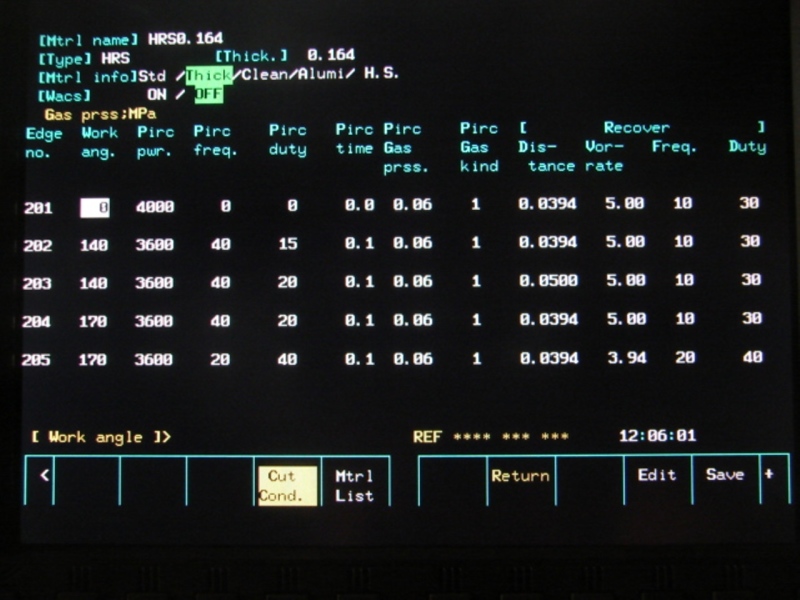

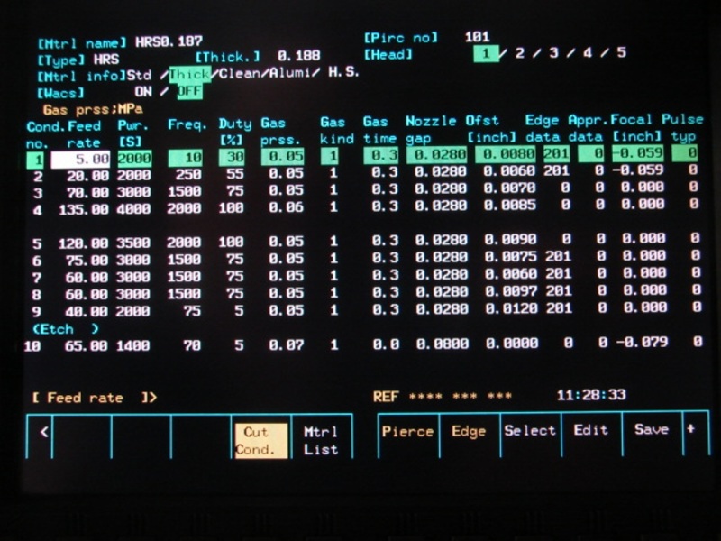

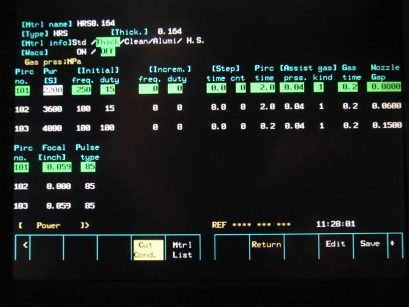

hi i have worked with lasers for a while but this is the first time with amada 3015 fanuck can any one give me a grate piercing and cutting conditions wor 7 ga hrs and .188 hrs. also if you have best conditions for from 18ga crs to .625 hrs please give me . thanks

thanks, i was wondering the piercing tables you have selected 101 but the conditions for piercing was not shown, can u please post that to as well as edge also.

I put my conditions on an Excel spread sheet but I can't post it for everyone so if you have an idea on how I can get it to you let me know.
