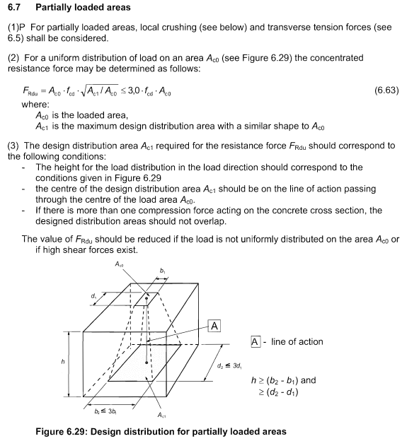

I have attached a scheme.
The bottom concrete must be able to resist compression transmitted through the upper concrete. Of course, it will be easier if the angle is wide, until it gets truncated.
I have checked uses 1V:2H (63 deg), but EC-2 defines 2H:1H (27 deg) which is radically different. (I am not confused with the angle and its complementary)
And it is curious but I have typically used 45 degrees for a long time. But when I tried to authenticate 45 degrees I didn't find anything.

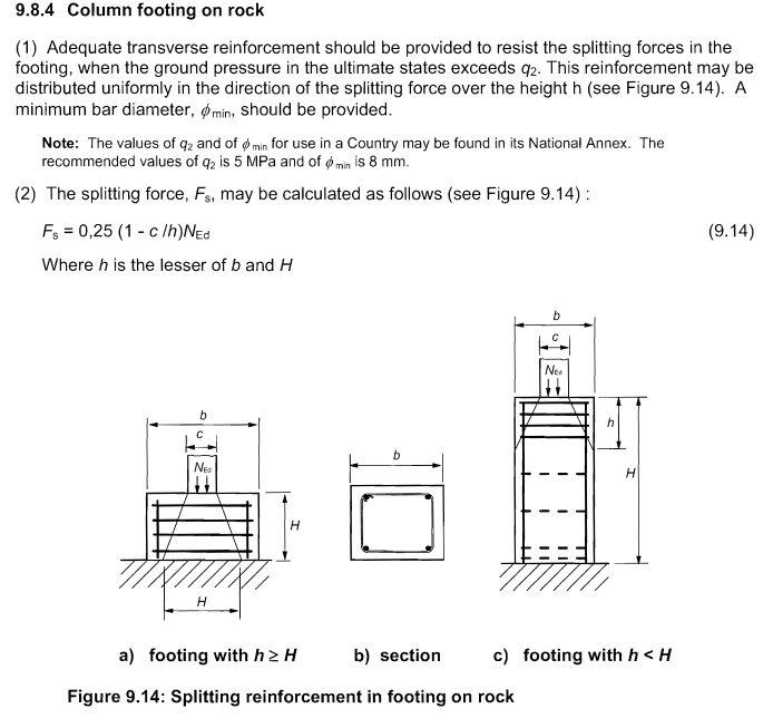

The clips below show a couple of European code sections that may find application here. There first is very similar to the provision that calvinandhobbes10 posted which would be the go to clause in North America.
If you have the opportunity, I would be inclined to reinforce the upper concrete such that you can assume the load to be spread out over the entire pedestal width. The lower concrete will likely flex and result in the upper pedestal load being delivered closer to the edges of the upper pedestal anyhow.

Section 6.7 of EC-2 is equivalent to 10.14 of ACI. But in the first case the angle of transmission is 26.6º, and in the second case the angle of transmission is 63.7º. How is it possible??

Sorry, I did not explain well. 26.6º is the value which is deduced from the section 6.7. Taking into account that b2<3·b1 and h>b2-b1; angle maximun if b2 max, i.e. b2=3·b1, h=2·b1, so, angle=atan(((3·b1-b1)/2)/2·b1))=atan(1/2).
RE: Stress distribution through concrete
Hi, the 26.6° of the Eurocode is the maximum inclination of the tie and strut model to compute shear. You can take another angle if you want but it will impact the tie and strut model equilibrum.
