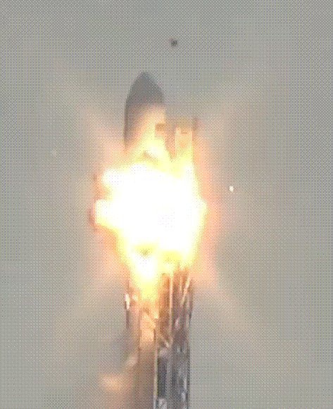

RE: SpaceX Comm/Facebook Satellite toast.
I'm guessing the fully stacked testing is expected to prove the engine thrust, fuel valves, pressure sensors, and the full launch vehicle's electrical connections are not vibrating apart. It's not expected to be a blow-up event like the much more hazardous launch is. Indeed it seems like the problem was completely unrelated to the vehicle and really a plumbing-to-the-vehicle issue. That's why I think the payload is present and will continue to be present in all future missions.
Looking at the initial explosion you can see, what probably is, a pipe fitting being launched up and away from the fueling connection area.
Note the two pieces in this frame.
I wonder if someone left a greasy fingerprint somewhere that the LOX took offense at.
