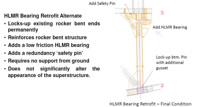

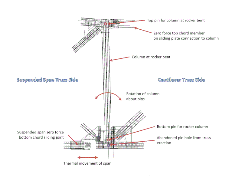

Does anyone have any knowledge of a truss rehabilitation project (anywhere in the world) that involved installing an HLMR bearing at / near one of the panel points to effectively replace the pin?

Something doesn't look right with your sketch labels. In a typical cantilever truss, one would expect the cantilever span to be on the left with the suspended span hanging from the vertical. Could you post an elevation view?

@ bridgebuster:
what I posted were just conceptual sketches that someone else created, so I can't (and wouldn't) trust them as bible verse.
...plus this is a really weird bridge.

RE: Truss Bridge - HLMR retrofit
What happens with this joint in a seismic event?
Seems questionable to me without some form of movement limiting venue as it would lead to a loss of vertical bearing and collapse.

@msquared48
At this point, I have no idea what happens to the joint. That's why I am hoping to stumble over a project that actually used this sort of retrofit. :-)
Conceptually, I THINK the "safety pin" that was shown on the sketch is meant to limit the movement.
