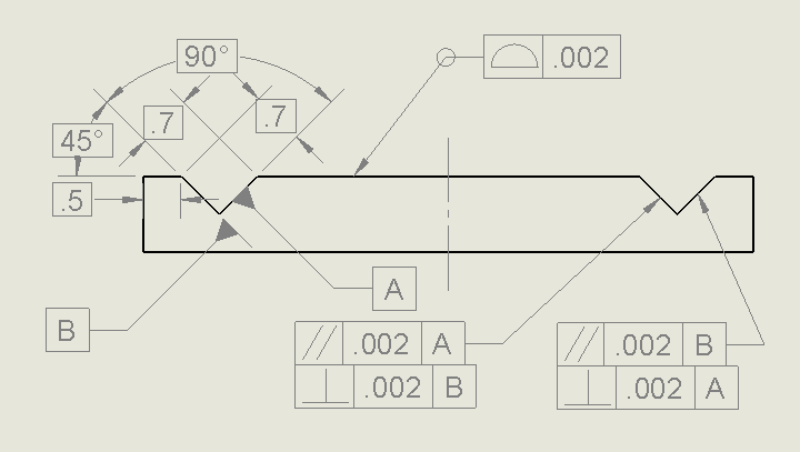

Assuming I have a double V block part as shown below, and the design intent is to keep the axis of the two imaginary cylinders lying in the part parallel and in the same plane, what is the best way to do this?
I have some ideas as to how to make this happen (below), but I am unsure as to how I would actually QC the parts in real life.

Oaklandishh,
I would not use an inside corner as a datum feature. I woudl use the two sides of the v-groove as datums A and B, respectively. How does your inspector demonstrate that the corner of your v-groove is at .500±.001? This is a good case for profile tolerances. The second v-groove faces must be parallel and perpendicular to datums A and B.
You can make the two grooves parallel. Making the centre to centre distance absolutely precise will be way more challenging.
JHG
RE: Keep axis parallel and in same plane with GDT?
So Something more like this?
The Profile Dimensions the first slot where the datums as well as loosely dimensioning the other slot are and the parallel and perpendicular are used to refine the other slot relative to the datums?
I assume I would check the parallel and perpendicular callouts using the datums A and B notch clamped on a gage block and then just running a dial gage on the other slot's surfaces?

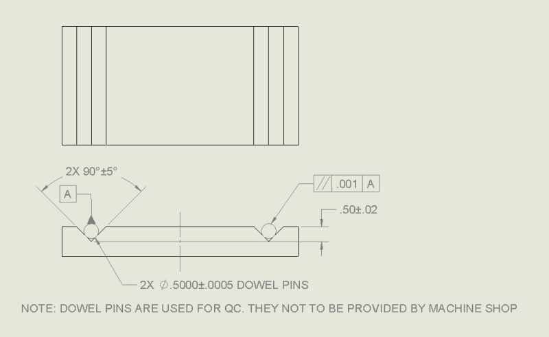

Relating to Pylfrm and 3DDave's comments. Is this an acceptable thing to do?
I am at a small company, so I do the QC as well as the drawings, I would much rather have something easy to QC.
Parallel implies parallel and planar correct?

I strongly second the application of tooling balls/gage pins for use in verifying the parts. This reminds me most of a sine plate or sine bar so I'm going to approach it with that frame of mind.
Your last drawing looks best, to me, in post dated 07SEP2016-15:28.
What I would do: specify an appropriate flatness on the base surface (opposite the grooves). Dimension from that flat surface to a line tangent to the tops of both gage pins with +/- .001 or w/e is appropriate. This controls the depth of the vee-grooves without concern as to the location of the actual vertex, as your dimension is doing. This is especially important when you don't really care about the angle, which, if your +/- 5deg is true; you don't care much. You could constrain the orientation of the gage pin centerlines as being both parallel to eachother, and parallel to the base surface. The numbers may or may not differ, but it establishes the plane they must stay on, and also controls the allowable taper relative to eachother.
This makes it easy to check, as you can rest the part on a surface plate with the "vees up" and check it with a height gage, test indicator, and/or other simple gage tools on-hand. It is also likely pretty close to the parts actual functional requirements.

Oaklandishh,
Tolerancing an assembly like you've shown is indeed acceptable, but it has some disadvantages. Now you have to worry about various possible form errors in the dowel pins for your tolerance analysis. Such form errors can also lead to disagreement between inspections using different pins. This is why I suggested using imaginary perfect cylinders and the datum target notation. It certainly does shift some burden to the inspection side though, so you'll have to judge the trade-off.
In any case, you should probably consider specifying how the cylinders shall be held in the V-grooves, and any additional requirements needed to ensure stability or repeatability.
Also, in the parallelism feature control frame of your latest drawing, the tolerance value should be preceded by a diameter symbol. This will create a cylindrical tolerance zone for the cylinder axis and control both rotational degrees of freedom (parallel and planar to use your terminology).
Unless it's functionally relevant, I'd recommend against involving the base surface in the parallelism tolerances. An inspection of the pins alone shouldn't be too difficult with a surface plate, height gage, and test indicator. One option would be to place the part upside down on top of the pins, using riser blocks as needed. The setup could then be rotated to place one pin above the other for inspection of the other degree of freedom. Pins somewhat longer than the grooves will make this easier.
I agree with JNieman on the point about not tolerancing the location of the groove vertex.
