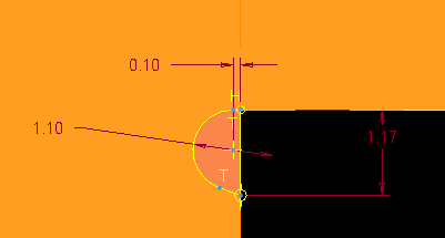

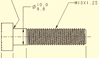

I am looking for any info on how to design an asymmetrical o-ring groove under an M10 bolt head. I've already chosen the O-ring size. It's I.D. is 10.03 +/- .13 & it's section width 1.02+/-.08.
I want to make sure the groove accounts for the o-ring stretch round bolt. The Parker O-ring handbook seems to have info regarding squared gland dimensions based off your o-ring size. I need info on an asymmetrical grooved gland. Am I making any sense?
See attached pics for bolt drawing and example of what I am trying to come up with (i.e.self-sealing fasteners)and the sketch of the groove I have so far.

I can't help but some questions/thoughts that come to mind:
1 - Are there provisions in place to ensure the bolt is not rotated during assembly?
2 - Aren't you reducing the load-bearing area under the head of the bolt?
It seems like maybe an option would be a washer under the bolthead and a bigger diameter o-rinig / groove so you don't have to worry about the radius of the bolt head.

Two things to consider with your groove geometry:
First, the groove shape should only produce sufficient compression of the o-ring for the pressure levels it will be subject to. In general, for static seals lower pressure should require less installed compression of the o-ring. And keeping installed compression to a minimum is usually better for the o-ring. Attached is a chart that shows flattening of an o-ring cross section due to circumferential stretch.
Second, as a rule of thumb, the o-ring volume should be no more than 80% of the groove volume.

If you have the Parker Catalog, have a look at the triangular groove details (4-21 / p101 of their 50th anniversary edition catalog). It may be enough for what you are looking for.

Thanks everyone for their responses so far.
Quote (electricpete)
1. Yes
2. The load-bearing reduction will probably not be a factor in this design intent, but definitely something to rule out as a problem for sure...thanks for the thought. I am also looking into a self-sealing washer.
Hope that helps.
It most definitely helped! Thanks for the info tbuelna!
