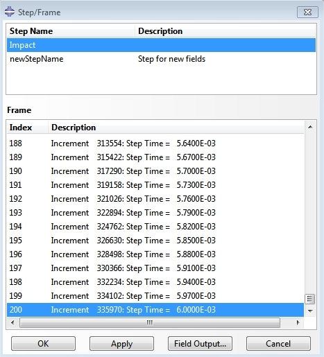

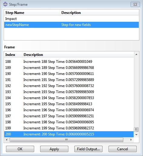

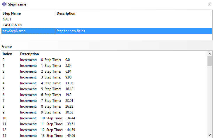

I revised the code and found some mistakes but nothing related with the indexError. Also I added a +1 at the for loop to complete all the frames. About the re-ranging of the time domain I did't see what you said. I send you some screen shots:
Old step:
New step:
Odb information
It's hard to debbug without the odb file, but if you send me this captures of your odb file maybe I can try a new shot.

I am doing explicit analysis of 0.006 second, so rounding off the time is not required. Also, can't share the .odb because its ~50GB in size.
1. I did not see any loop counting even though it ran through system cmd and in CAE kernel cmd interface.
2. I have total 201 frames, forgot about the frame id 0.
3. The new step has been created, but its not being saved due to the following error. As soon as I reopen the .odb, "newStepName" disappears.
New error -
File "Rename_odb.py", line 21, in <module>
tempTime = session.odbs[Odb].steps[StepName].frames[N].frameValue
IndexError: Sequence index out of range
Perhaps the loop is not finishing completely?? You see that the Total time at the end of step (Frame ID 200) does not match.
Old step:
New step:

@rrg1016 - I think I know what is going on.
CODE --> Python
nFrames=odb.steps[StepName].frames[-1].frameId #frames number
StepTime=odb.steps[StepName].frames[-1].frameValue #total time
print nFrames
print StepTime
I have printed these two variables and nFrames came out to be 314108, which is actually increment number. I have also used 199, 200, 201 directly instead of nFrames in the range() function at the for loop and it worked fine, 202 gave same "Sequence index out of range" error which is logical.
So, frameId object is not the frame numbers, it is increment number. Also, there is no need to add +1 after it.
Please note that, the so called frame numbers are shown as "Index" in above pictures. We are looking for something like odb>step>index. What is the right object name for this??
