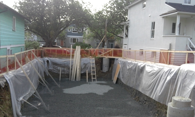

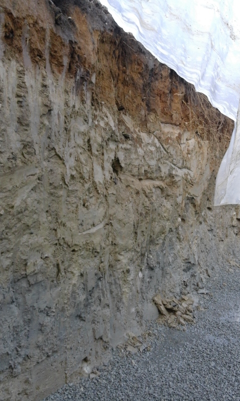

This is an image of a not uncommon excavation we provide safety letters on.

The photos that NorthCivil posted give me heartburn. Look at the depth of cut vs proximity of adjacent structures, and the moist soil. There appears to be a lot more faith and risk taking involved than actual engineering. May the odds be with you.
RE: Temporary trench excavation
@ATSE, I had the same thought when I saw those pics.
i can't think of any engineering reference that would say how to handle that cut in the photo except with shoring. rules of thumb about excavation depths are for cuts in the middle of an open field. the soil along the sides of each home is a 4 ft wide sliver for the length of the building. you won't find a rule of thumb for that. there could even be an opportunity for hydrostatic forces to come into play based on some hidden condition with existing foundation drains.
I'm hoping those two adjacent buildings have basements of a depth around that of the excavation, or that's terrifying.
to put another viewpoint to the concern TLHS shared. my 1st statement assumes the canadian homes footings on both sides have a 5' to 6' of frost protection cover and won't contribute weight or potentially open the door to legal complaints about settlement due to this construction. i'm pointing out that the normal slope stability and excavation rules references which an engineer can hang their hat on don't address the scenario when there is a buried wall creating a vertical failure plane immediately behind the excavation. the soils in the open cut are native but at what point do those soils change to the foundation wall backfill...6"... 12"...18"...etc... and what do we wish to guess is an accurate description of that fill to say it will be stable. i would personally get in that hole, but i wouldn't feel like i could defend a letter assuring that a bank won't slough off while somebody is tying footing rebar. i know this was just an example, but i'm just throwing this out for the general public since identifying and communicating unseen and unknown risks is a valuable engineering habit to develop.

Littleinch, you are correct, I used improper terminology to describe what is going on. these are technically "shallow" excavations, with straight cut walls. You are correct, our "sign off" is peppered with all those clauses and more. We have our own limits as you describe.
Still haven't found many resources to guide me. Though, from what I see, this type of excavation is typical in our area, and has yet to fail. The cohesive strength of the clay is holding everything together, though like others have said, its difficult to quantify, and there is potential for unseen slip planes in the clay.

there were a couple of comments in your last post that make me want to take another stab at explaining a potential hazard..... the cohesive value to the clay requires an understanding of how thick the soil bank is behind the open face. cohesion could even be considered a function of that thickness. imagine a direct shear test where you run it on two identical samples of undisturbed clay, but the second time you cut the clay sample in half vertically, and remove the back half the sample and stuff it with cotton (you could put sand in as filler but we're testing cohesion and we don't want sandy internal friction angle data corrupting the test since that sand won't help the bank) ... performing the test this way, you should expect wildly different soil cohesion results. the clay (maybe a silt) looks fine on the surface and the concern about slip planes are not inside the clay but the vertical cut behind it. to be fair, i would believe the undisturbed soil likely goes pretty close to the existing adjacent bldgs since those excavations got there first and would likely have stayed pretty tight too, but as you know "likely" isn't good for reports. the concern i raised is not hypothetical. this condition falls many times and you will see it fall too. Fortunately, the vast majority of the events will occur during excavation, overnight, during rains, or when nobody is right there in the bad spot. The most common scenario for this classic failure is when the contractor is trenching in a new utility adjacent and parallel to an existing utility trench and the bank sloughs off back to the old vertical cut from the other trench wall.... and like i said... usually happens during excavation when nobody is down there and likewise goes unnoticed.
