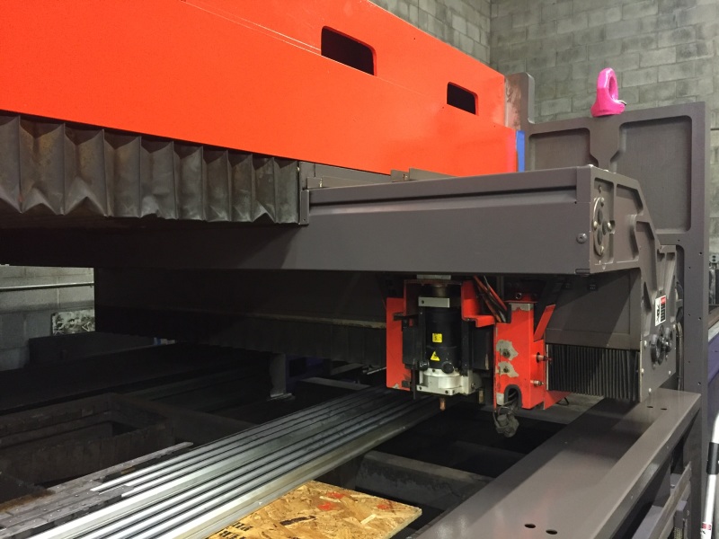

On the byspeed you can cut way back on the beam delivery purge air. They set it at 3 bar, you can run about 10 psi you'll have to adjust the low pressure switch. This will cut way down on the air consumption.
On each axis on a bystronic there are 2 bellows, the beam only goes through one, the other one is simply for keeping the beam delivery bellows from collapsing or blowing up.When you move an axis one bellows opens and the othe r bellows closes and pushes all it's air into the one that is opening. Constant volume system.
On some bystronics they only used one bellows on the Y axis and if you moved the axis real fast the bellows could collapse on the beam and catch on fire,They cranked the beam purge air way up to combat this. Eventually they went back to having a balance bellows on each axis but never turned the beam purge pressure down.
If you see the bellows collapsing then turn the pressure back up a little.

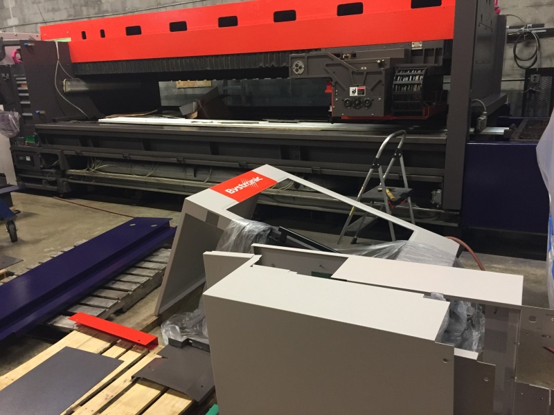

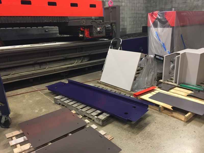

@krugtech, thank you so much for your feedback. here are a few pictures of our Bystronic BySpeed. Looks like we have 2 bellows. Please excuse the mess as I'm going through revamping the entire machine to make it brand new and giving it a paint re-haul. So you're thinking that we should be fine with 3 bar constant pressure? I guess I was trying to understand if we could use our existing air compressor (Ingersoll-Rand 7.5HP/80-gal. that can provide 27.2SCFM @ 90PSI or 25.1SCFM @ 175PSI) or do we need to buy a more nicer rotary screw compressor of 10HP or higher? If we can use the existing compressor, are there any specific dryers that you recommend? Thank you again!
