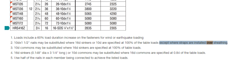

Quote (mikeCTE)
i will add some CS16 straps around the windows to tie everything together
1) Those straps will need to engage blocking running beyond the opening to be effective.
2) I'm not 100% sure but I suspect that the strapping may only be effective when installed before the sheathing.

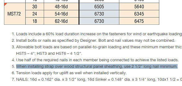

question on the strapping? it seems to me that it would be better to get your plywood to fully bear on your studs so that the nails can shear properly. if you put strapping in first, this will create a gap. if you put strapping in on top of the plywood, the nails seem to shear better and it seems like you would get the same shear value regardless.
RE: pony wall shear wall (seismic retrofit)
I disagree regarding the strapping.
Firstly, the strapping should be of such a gauge that it does not interfere with the fastening of the sheathing to the studs and blocking. There is a gap but it's of no practical significance.
Secondly, I believe that the load path in these situations goes:
[sill/head plates] --> [strap} --> [blocking beyond the opening] --> [sheathing]
As such, by putting the straps outside the sheathing, you're creating a 1/2+ gap in the portion of the load path represented by the connection between the strapping and the blocking.

sure, the straps are 16 gauge (or 11 gauge for some of the ones i plan to use). that's enough of a gap to me. any gap between the plywood and the studs would seem to be a weak point in the shear mechanism in the nails.
if you put the strap on the outside of the plywood, yes, there's a 1/2" of material between the strap and the stud, but there's at least continuous bearing of shear material, right?

Quote (mikeCTE)
If demand were that high, I'd probably either alter the design or go with two straps side by side so as to facilitate the use of a more manageable gauge. A three millimeter thick strap represents a TON of tension force. You must be running that strap practically to your neighbor's house in order to develop that much force into your sheathing.
I'm not sure what "continuous bearing" gets you with respect to shear resistance? Bearing doesn't help resist shear forces except, perhaps, in the friction sense which isn't what you're doing here. The strap's job is to transfer axial force from the sill plate to the blocking beyond the opening. That 1/2" gap weakens the capacity of the nails to perform that function.
It's not as though you can't put the straps outside the sheathing if that's really what you want to do. The fasteners would just need to be adjusted to reflect there reduced effectiveness with that 1/2" gap in there. See the notes below from Simpson's literature. You basically have to use longer / larger shank diameter nails to compensate.

thanks for that post (and this discussion). i'm already using 10d common nails (3"x.148") so it seems that nailing the straps to the top of the sheathing will work for me.
