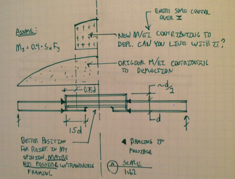

I like the method that you've proposed bookowski. Below is a sketch showing my musings on how I might approach the deflection calculation. I like my stiffener positioning but, based on intersecting beams etc, I understand that it may not be possible. I use jacking sparingly in situations where the jacked member is attached to a bunch of other stuff (slab etc) that may be helping to resist load in situ. I consider the potential disruption of those ancillary load paths to be a) scary and b) generally detrimental to stiffness.
Curious: spatially, how is it that you are able to accomodate the proposed WT reinforcement? Is it buried in the back wall of the stair opening? Does that limit how far you can extend it on either side?

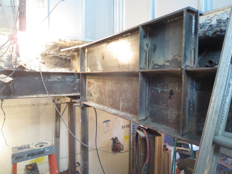

I'd like to do the horiz stiffeners as well but if you look at my first sketch the beam that actually carries the transfer column frames in just to the right of my cut. Money is sort of no object here so I could do some combo of both... or maybe modify the connection on that beam to get it out of the way although that's a bit scary.
Yeah I can basically run the wt as far as I want. It's a weird old construction oddity that is helping me out here. This is a penthouse and has terrace all around (overlooking central park!), instead of dropping the terrace slab like we'd do now they kept the framing flat and built up the interior with almost 1.5ft of cinder fill and then a topping slab on that. So I have that entire depth of fill slab to work in.
Your 'exert control over I' note is what I was thinking. If I give myself >>> more than I need then it should take very little strain to develop the force and thus very little additional deflection (hopefully). I'll have them survey it before and after to see what happens.

In case anyone runs across the same setup - photo of the reinforcing in place, cutting of the existing beam will happen soon. Due to the geometry I could only provide vert reinf on the photo side of the beam, on the far side is a horizontal stiffener (you can see some of the staggered welds reflecting through the web)
