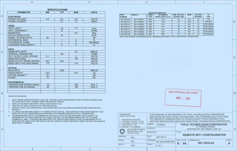

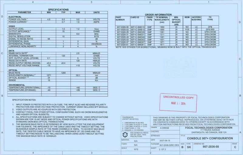

We have an ROV system which is using a fiber optical for data and video transfer but unfortunately it does not have the capability of carrying HD signal.
So, for almost 20 years, we have been using cheap composite video signal camera. We have engaged the fiber optic people and the price to upgrade is not cheap.

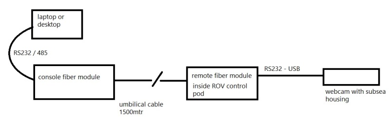

I just want to know if anyone have ever try or suggest if i can use a USB webcam and use converter to RS232 or 485 and transmit the signal to the surface.
Bare in mind that we can't use any software in subsea unit but on the surface (control cabin) is not a problem. Please refer to my attachment for reference.

That's a good idea too. The only problem, our subsea control pod already has a fiber module as per drawing (remote) and the connector are all dedicated to certain function. But we have dedicated RS232 and 485 outlet through the fiber module for sensors (sonar, etc). Note that the video input/output is only meant for composite signal as i mentioned earlier.
That's why i think maybe there is a chance to use the RS232 or 485 channel with the usb camera. My only concern is can it work before i start to purchase all the required stuffs.
From what i know, the USB to RS232 converter run through a software, so, will it work if i run the software from topsite since it is impossible to do it in subsea.

Then, I think you're smoking something really good.
Full HD is 1920x1080, so even at 1 bit/pixel, compressed, and 30-Hz frame rate, you need 62 Mbps, which is not going to happen with standard RS-422 or RS-232. Some sort of LVDS might manage that.
