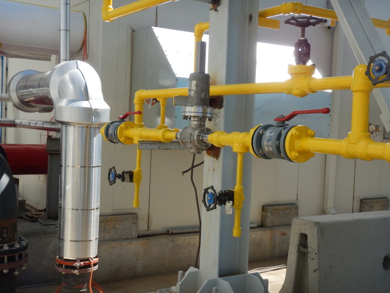

Hi Everyone,
Piping sub-contractor bolted together carbon steel piping spools and painted as it was bolted all piping spools including studs and nuts too. This is small bore piping (=<2") for Auxiliary Nitrogen System of power plant.
1. Is there any issue with painting all studs and nuts?
2. How about not painting of flange faces?
Thanks,
Curtis

Getting those bolts off in months and years ahead will be far more difficult. Possibility that corrosion will occur under the paint layer un seen.
I assume you mean inside the made up flanges and not the flange face prior to mating? Assuming its all bolted up, painting inside the flanges isn't a real problem.

Thanks for your brief response. We have 2" x 150# SW flanges. They painted only back and OD surface of the flanges. I think they suppose to paint inside bolt holes, flange face except raised face surfaces. I might be wrong though.
Who knows how properly apply standard ANSI flanges?

I don't recall bolt holes being painted unless the entire fab was pre spray painted and this required the ends of the flange / sealing faces to be protected with tape and sometimes paper stuffed in the bolt holes to prevent paint getting in there and pooling.
There are no mandated requirements for painting or non painting other than removal from surfaces to be welded.

Items such as machined flange surfaces should be protected to prevent damage or contamination during blasting or painting. Normally, the raised surface of a flange is never blasted or painted. (Those surfaces are sometimes referred to as machined, and this is where the gasket sits. The rest of the flange surface is blasted and a coating is applied. If the question originates from a project, the best answer may be found in the project coating specification.

1. Those lines are field run and supported by equipment supplier (Supply & Install) sub-contractor up to tie-in points.
2. Lines are fabricated on site, supports are attached to existing steel, and bolted together.
3. I think they hydro tested piping assembly after installations, and applied prime coat and final coat without disassembling spools.
4. I'm uploading a picture to show you all a fragment of installations.

The installation guys might get away with it, they might not.
You would need to see what the installation specification said to be on safer ground either way.
RE: Spools Painted with studs and nuts
If grease or a corrosion inhibitor had been correctly applied to the studs the paint would not adhere so it is obvious nothing has been put on the studs.
Pull them out and do it properly,
