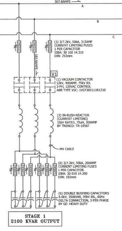

Hi J.Karthik,
Below is a cap-bank for a recent project. Each stage is rated 2100kVAR at 6.6kV, and supplied with a 75uH reactor. The reactor size was selected to limit the inrush current to the caps, and to prevent resonance with the balance of plant.
As cranky108 mentioned above, air-core reactors are generally lighter and less expensive than iron-core units.
A reactor in this class can be defined with the following units;
- inductance
- voltage & frequency
- Ampacity
- BIL
- insulation class
- temperature rise
Regards,
GG
