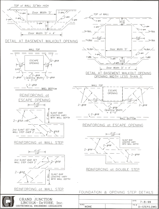

Step Details my firm has used since'97 and previous by my Father since the early/mid 60's. We have worked with a lot of foundations on slopes, including walk-out basements.

I can't see the attached file.

RE: Stepped footings / Stemwall Design
You can't upload things to engineering.com that have spaces in the title. Found that out once upon a time.

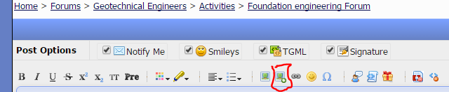

Quote (BigH)
How do you embed the photo in the post??
1) Bring the thing up on screen.
2) Use the windows snipping tool to capture the image and save it someplace.
3) Use the button circled below to select the file for inclusion in your post.
#2 can be skipped but can lead to weird results with respect to display size etc.

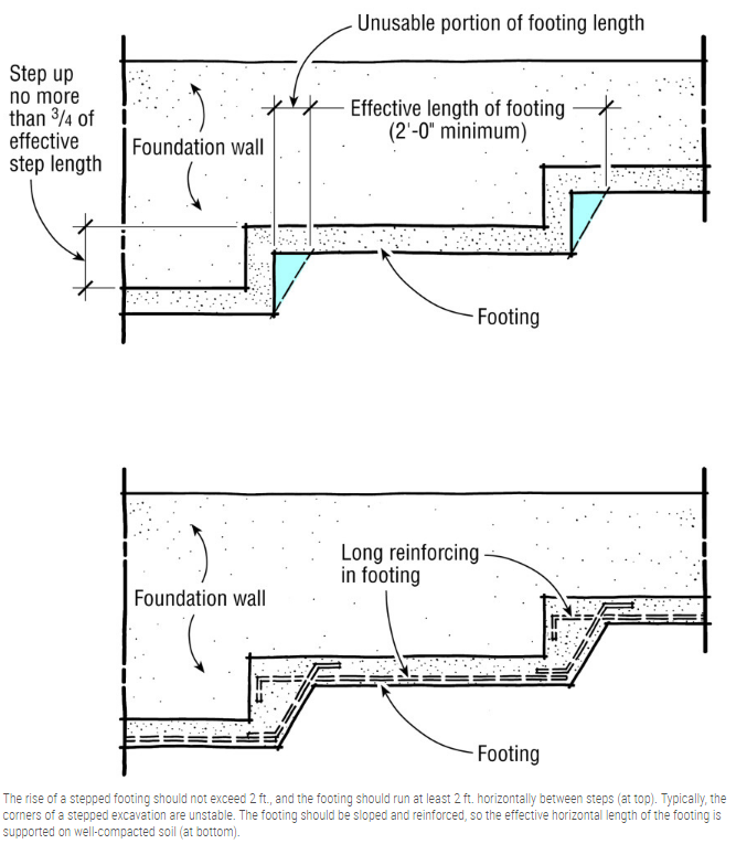

I found the blurb below at the journal of light construction website which takes yet another tack. They don't count the portion of the soil in the "wedge" as bearing. I've not accounted for that but I can certainly see the logic in it.

Our typical stepped footing detail is similar to your alternative 1. I did a quick search of the internet to find the reasoning behind IBC §1809.3 without much luck. The only thing I found is in FEMA 232 Homebuilders' Guide to Earthquake-Resistant Design and Construction (2006) where it states "To aid in providing sliding resistance, the bottom of the footing should be level." See oage 60 (pdf page 12) in https://c.ymcdn.com/sites/www.nibs.org/resource/re...
I think most engineers wouldn't upsize the footing to compensate for the little wedge of excavation at a steep angle. While I have nothing against JLC, the cranked bars at the wedge don't make much sense to me unless they are more fully developed to prevent cracking at the reentrant corner.
