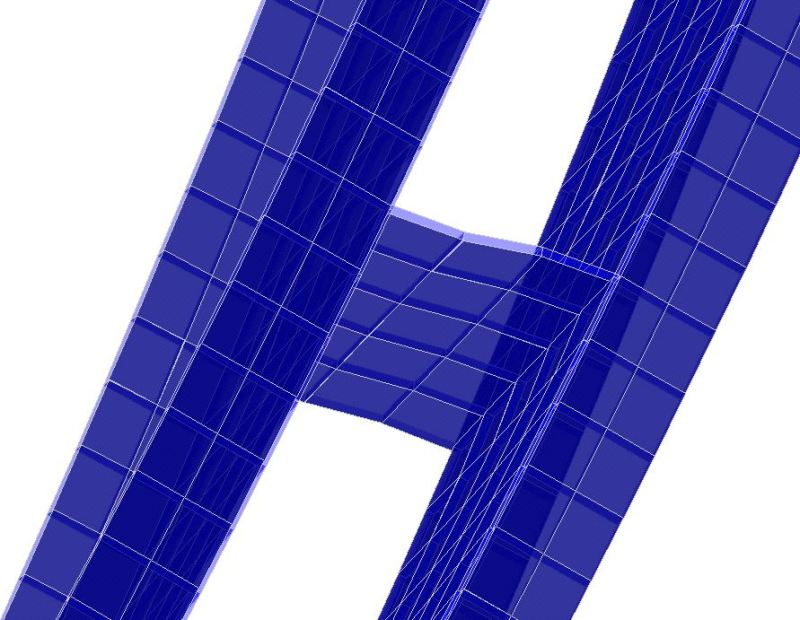

If the vertical stiffeners bend as per my plan view diagram, there will be relative movement along the length between common points on the two top flanges.
Thus, the two top flanges may also have different deflections laterally relative to one another and the rotation angle of each channel could be different.
If the rotation angle is different then they aren't behaving as a complete composite, locked-in shape but rather two shapes that are connected together in a semi-rigid mechanism.
As KootK stated, determining the LTB performance of these channels with vertical plates and a semi-rigid relationship is "tricky"....in other words, it would take more time than its worth.

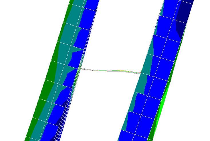

I can't see the plates bending like that... it would take an exceptional amount of force between the two channels to yield them. In fact, if you use staggered plates to make a box section, you're actually even weaker with respect to bending in that manner.

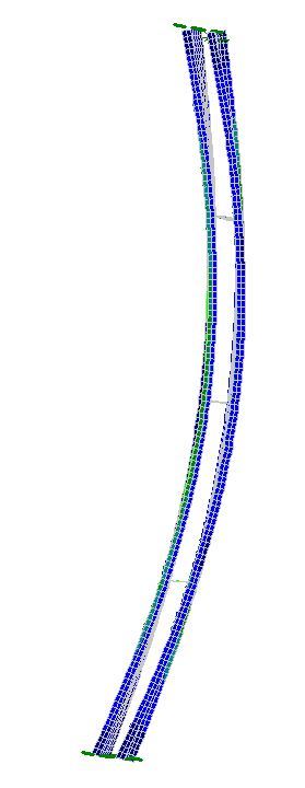

canwesteng - it depends on the span of the channels and the thickness of the plates. If the plates are 1" thick then yes, they may not bend as much.
With a 20 ft. span, heavy loading, and 3/16" stiffeners at 48" o.c. I can certainly see these wet noodles bending.

Here's a few images of a quickie model I made:
C10x15.3 channels spanning 20 ft. with a 6 inch gap between them and 1/4" plates @ 5 ft. o.c. between them.
An overview of the two channels:
A close up of one of the end plates with a deformed bend in it: (note the bend is as I've drawn it above)
