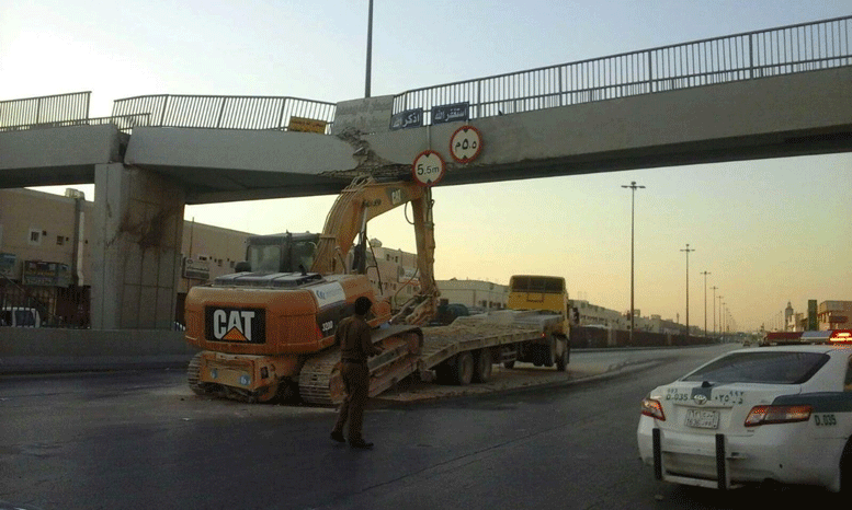

Unlikely that a designer can forsee all the stupid things people do when hauling equipment. Fortunately most roadway bridges have enough mass that complete failure does not happen. For example take this OG. I had a bicycle attached to the top of my car and went under a very low rail road bridge well marked to keep trucks out. The bike escaped with maybe with maybe 1 mm of clearance.
RE: Lorry crashes into and demolishes pedestrian bridge.
Interesting that the excavator doesn't even look blemished after the event. It makes that bridge look a little tooo weak to me.

Maybe not. Seems 60MPH excavators pack some serious kinetic energy.

Enough energy to put the draggin' wagon frame on the ground too...

I see , if an excavator can do that to a vehicle bridge, a pedestrian bridge does not stand a chance.

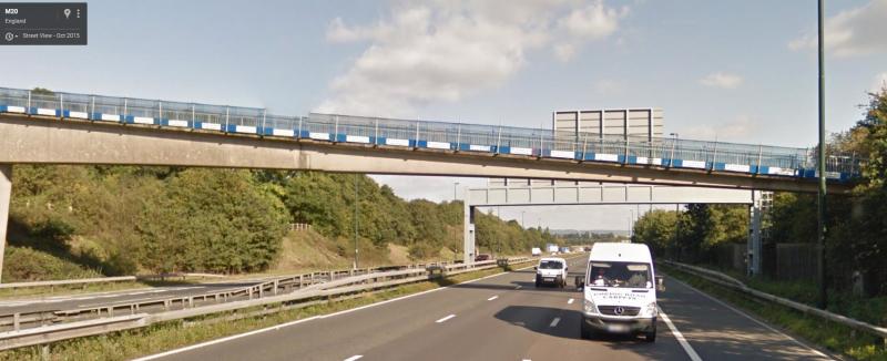

There is something odd about this.
The lorry with the low loader was apparently going slowly along the hard shoulder.
It has clearly passed under the gantry sign just before it.
The footbridge is a curious design with a narrowing section to allow a slope on the bridge while keeping the bottom flat and set height above the carriageway.
It would seem that the bridge section just rested on the pillar and on the midway joint.
In terms of backing up that is what happens normally. However, the location here was odd. The London bound carriageway was not far from a junction and was cleared. The southbound carriageway - the one with the bridge still standing is just beyond a complex motorway junction which made it very difficult to reverse traffic.
In the end they decided that the bridge left standing was secure and allowed traffic under it.
Motorway was closed for a day and a half.

Difficult to judge from any photo I've seen and especially when you look at vertical distance above the edge of the hard shoulder, not the extreme end.

OK,
Some more digging (excuse the pun) finds a bit more evidence.
This pic is the best I've seen and given that the low loader is currently crushed under the weight of the bridge so probably 0.5m lower than it would have been and an eye witness report who heard a "loud bang", it looks like the digger arm hit the side of the bridge hard enough to hit it sideways off its support on the outside of the carriageway.
Now whether the bridge was as high as it should have been or the digger was over the maximum height is going to be the key question.
I think the timing of it, the fact it hit the lorry first and the now near universal application of anti-lock brakes saved us from a multi vehicle pile up. That and the bike rider who just managed to slide under the bridge as it collapsed.

IR stuff,
That's a good view, but exaggerates it a bit as the edge of the hard shoulder is the key bit as the bridge is definitely on a slope down. The modern bridges and gantries are apparently 5.5-5.7m, but the bridges only need to be 5.03 (16 ft 6") though whether that applied to the hard shoulder when they built the motorway is not clear.
either way its quite a bit less than the gantry.
Interestingly the HSE website quotes 5.1m (!) and the new super tall trailers are up to 4.9m. Definitely scary seeing those go under some of the bridges.

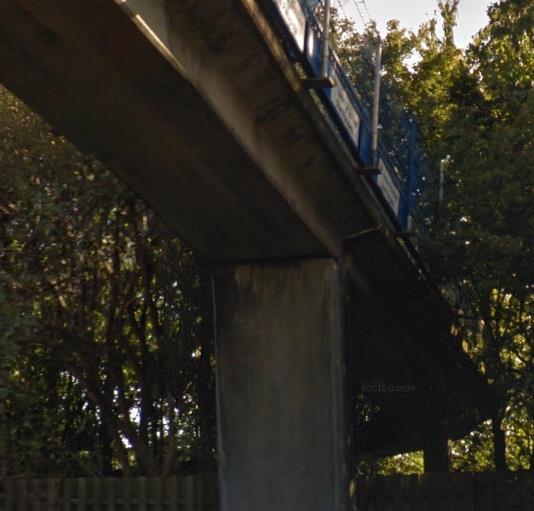

Anyway, looking at the pictures of the pedestrian bridge, is it my imagination or does it not have much (any?) visible rebar where the break is?

No its not your imagination. The design of this particular bridge is a bit odd and the section that feel off was basically a simply supported beam resting on two supports. The far side of the bridge is a much more solid cantilever....

Two separate pre-cast sections lifted into place, held there by gravity and the grace of God. And maybe a little engineering judgement that didn't foresee forty-odd tonnes hitting it at 56mph...

Apparently the lorry hitting it was crawling along the hard shoulder so 5.6 mph would be closer. ... Does seem remarkable that it was essentially gravity holding it all together for the last 25 yeasts.

Not too odd. "Cantilever" style bridge construction with a "suspended span". Fairly efficient, and very constructable.
Although I'm most used to seeing it for large steel trusses over waterways -- lower collision risk there!

Lomarandill,
To me, though I'm far from an expert, the odd thing is that there is one long cantilever over about half the span / motorway, then this beam between the end of the cantilever and what is basically a pin support. If you look back at the google streetview images I posted on 30/8 at 0843, you can fairly clearly see the beam section ends. The first half cantilever stood the test and was suspended over the motorway until it was demolished a few day later.
The design is also strange as the bridge deck is clearly on a slope down from one side to another but also narrows down as it gets to the far side.
I think someone went a bit too far trying to save on concrete and the height of stairs on the far side. This is a pedestrian bridge which then has a circular walkway on the side it was hit.
If anyone had actually been on it when it was hit it's fairly clear they would have died. how no one else was seriously injured is a minor miracle which might not happen next time.

Quote (LittleInch)
LittleInch, what you describe is pretty much the framing, using what appears to be cast-in-place section with dapped end (on the left), then the a precast drop-in (maybe should be retitled 'drop-down' surprised), with the far right end of the precast supported in a simple seat over the pier, as per below tagged photo:
The dapped end of the precast segment, in detail:
The far right support end over the pier:
This is somewhat common framing, using precast segments, and cast-in place too. Evidently, the lateral capacity of the simple seats is questionable.
