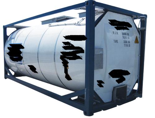

Dear friends,
During shutdowns of the plants many a times we need to bring different chemicals inside the plant in iso-containers.
Safety concerns have been raised in our company that this practice is not safe and poses many dangers/risks. The personnel opposing it say permanently installed fixed tanks should be provided instead of using iso containers. But this is cost to company.
I request you to enlighten me with your experience in using iso containers. I could think of the problems listed below. Kindly add yours or comment on what I have given below:
1) Hoses are used while transferring chemicals from iso containers which are not safe. Problems of spillage may be there. In permanent storage tanks fixed piping system is in place to take care of transfers.
2) Nitrogen blanketing which is permanently fixed with fixed tanks is not provided with iso containers making it fire hazard.
3) Fixed fire fighting foam system or other fire fighting system is available with fixed tanks. For iso containers movable fire extinguishers have to be used.
4) There is no proper method available to control flow in iso containers while in fixed tanks, proper instruments and controls are available to take care of flow.
5) Fixed tanks have proper access (stairs) to reach to top. In case of iso containers none is available.
Please give your opinion.

Proper hazard identification and management (administrative controls, additional design elements - if needed, adequate response plans etc.) is what will likely reduce the risk to tolerable levels. I have worked in 5 different plants where ISO-containers where utilized and operated trouble-free, on a bi-weekly or monthly basis.
See some of the links below, they all have sections dedicated to safety subjects related to ISO-containers:

1) Use hoses with dry break couplings - also place the isotainer within a containment dyke.
2) Check the upper design pressure limit for these isotainers and see if you can find an N2 press regulator that can work within this limit ?
3)You've suggested an alternative here
4)Pls elaborate - would you not be pumping out from this isotainer, so flow control would be possible ?
5)There are companies that make air operated movable elevated access platforms if you need to get access to the top of the isotainer.
RE: Problmes faced while using iso-container
You can just bring in containers, park them haphazardly and have hoses and tubes snaking all over the place or you can do it properly.
Have a dedicated area with a bund, fire fighting and monitoring, hard piping right up to the final jumper, portable sensors to fit to the tanks, valves on the hard piping etc.
I always hate the word "temporary" when it comes to hydrocarbon systems. The implication is that design, construction and operation can somehow be of a lower standard that is acceptable for "permanent" systems. This is the key thing to address.

And we have written procedures for bringing them in, siting, connecting, using, and removing them.
It is no different than having a place to load/unload trucks.
