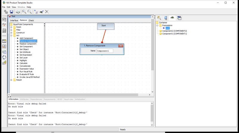

I'm trying implement a simple visual rule in PTS, but so far I haven't been successful. Let's take a simple case for example - if n < 2, then remove given component. As far as I know, I need to create a rule to remove a component, and then create a different rule with a conditional check invoking first rule if n is less than 2. But it doesn't work for me, PTS keep giving some error messages (that I cannot yet decipher because of my limited experience with PTS) and doesn't even allow to save a template. Could you please help?

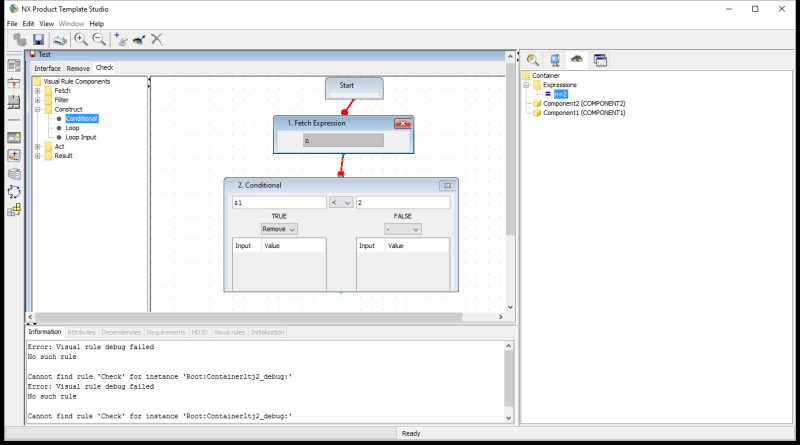

This is a generic example of what I'm trying to build - see the screenshots and attached .zip. The container file is PTS-enabled and hold two components. PTS interface has a drop-down list with two options - 1 and 2. If user picks 2, both components remain, if he picks 1, Component 2 is removed.
As far as I see, Remove rule seems to be working. The problem is with the conditional rule.

So, a couple of things I notice above:
a) In your conditional, you need an action for the right side to perform. Right now it's siting there empty, and that's not going to go well. If there's nothing you want to happen when a>=2, then you can create a simple DoNothing rule for this:
...and then your conditional will look like this in the end:
b) Your "Remove" rule looks great. smile And the fact that you've got it showing up in your conditional lets me know that you successfully checked the "Invoked From Visual Rule" toggle as you created it. Be sure to do the same with your DoNothing rule, so that you will be able to select it from inside the conditional control.
c) Make sure you have your rule hooked up to something. You'll need to associate the execution of your rule with some event in the dialog. In my test case, I hooked it to the control for the expression "a", like this:
[With the control for "a" selected, choose the Visual Rules tab, tell NX to run a visual rule when the value of "a" changes, and tell it which rule to run.]
Does that all make sense? With all of those pieces in place, it should run just like in the attached video.

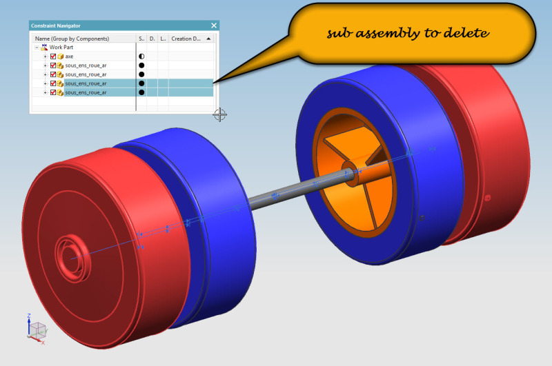

1°) My problem is that I have 4 identical sub assembly (sous_ens_roue_ar) and I want to delete only 2 of them
2°) Then I also want to be able to add them with original assembly constraint
Is it possible without using suppress component ?
