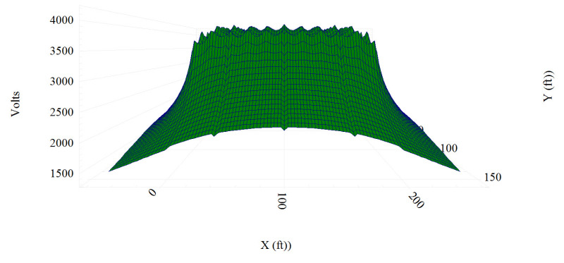

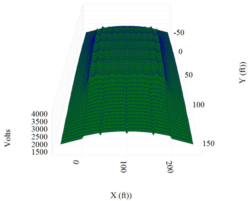

RE: Touch Potentials Beyond the Substation Grid System
Hi RS,
I ran a quick ETAP (FEA) analysis of your issue above, and as suspected the GPR roll-off is very rapid at the edges of the grid. Refer to the pics below.
The results are based on;
- a 100ft x 200ft overall substation
- 20ft x 20ft grid
- 20ft ground rods
- nominal soil resitivity
- Reultant 0.20 ohm ground resistance
- 20kA GF current
- 4000V GPR
Of course the soil resistivity plays a big role here, and you need to consider this for your circumstances. While the GPR was limited to an acceptable value here, the touch and step potentials were still excessive.
