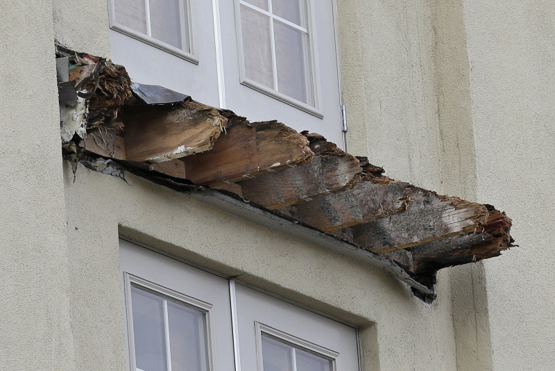

Remember this collapse in Berkeley a little while ago? : http://www.vosizneias.com/206607/2015/06/17/berkel...

As the image that JAE shows, I would never advocate cantilevering interior floor joists for an exterior balcony. The detailing of, and actual construction of, the building envelope requires careful attention and simply invites future problems. Far too many penetrations through the envelope and it will be prone to issues a la Berkeley.
The lifespan of an exterior wood-framed deck is far shorter than the structure, even using the best P/T products. How will the deck be repaired in the future when it is overtaken by rot?
I would rather see 2 or 3 steel members penetrate the building envelope and run the deck joists parallel with the exterior wall. This way the future repair/replacement of the exterior deck will be far easier and (hopefully) will not involve any modification of the building envelope.
