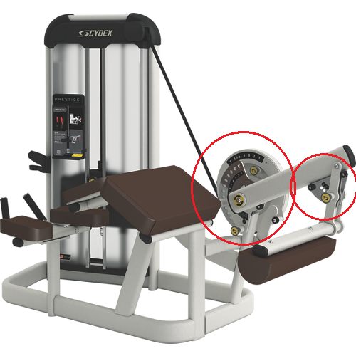

The first thing that came to mind for me was a regular hinge with a retractable pin that mates to holes at preset angles. This kind of mechanism can be found on all sorts of exercise equipment, this picture shows an example with it in use in two places.

Hi hendersdc, Thanks. Something like that was one of our first ideas. We were looking for something more compact, but it's good to get a reminder in any case.
