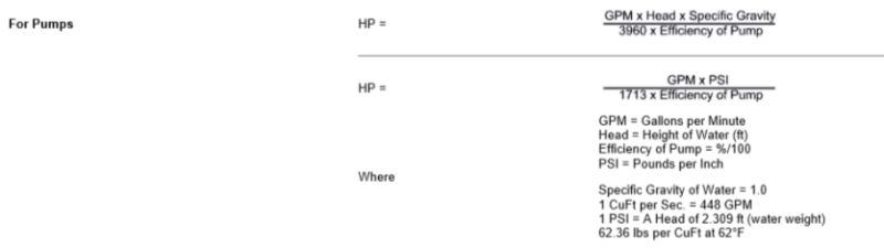

guys,
if we know the kilowatt of the water pump how we calculate the flow rate of the pump??????????????

Do you have data sheet on the motor and flow curve for the pump?
Otherwise it is just a guess.

If you work backwards in the pump power calculation, you may develop an estimate of flow.
1 HP hour = 0.746 kilowatt hour
Typical combined motor and pump efficiency = 62.4%

As bimr says.
First you need to know the DIFFERENTIAL pressure or head of the pump, not just its output pressure.
Then it's a bit of a guess as the efficiency. The small units ( 1-2 kW or less), sometimes have combined efficiencies of 40% or less.
The nameplate on the pump normally tells you all or just google the type of pump.

If you know the pressure across the pump and the power being used, using the calc.given by bimr-you could make a very wild guess as to the flowrate, bear in mind that it might be a meaningless crazy answer.

But we're all assuming it's a small pump. It could be a 500kW pump - who knows?
It could be a PD piston pump - who knows?
rish916 - do you know??

1 horsepower = 0.746 kilowatt (NOT kilowatt-hour)
