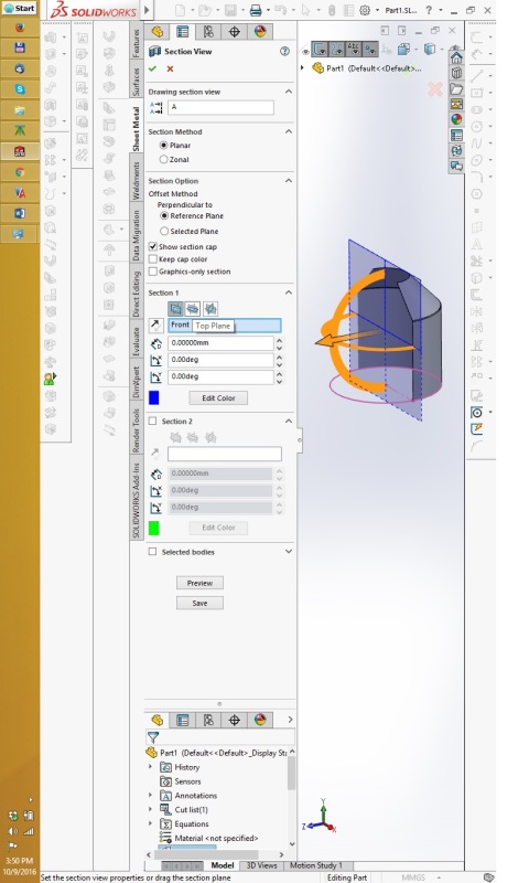

Quote (SparWeb)
4)7) can you explain how section view is more powerful in SW? I'm curious.
This is how SW 2016 section view options looks like:
In SW 2017 it became even more powerful, capable to display sectioned part in transparent, not totally hidden. But 2017 version is not official yet.
This is very interesting. Inventor's section views, when used in the part / assembly environments, is limited to just lopping off the ends / corners of things. And there is a completely separate means of making section views in drawings which makes little use of the model sections, if any.
Gladly cede the point to SW there!
