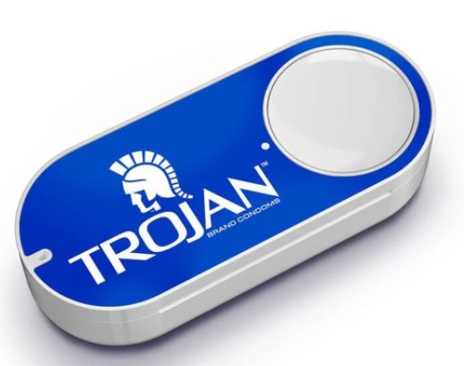

Is this not it? Just misdirected.
Here's the description:
Quote (AMAZON)
[Amazon Dash Button is a Wi-Fi connected device that reorders your favorite product with the press of a button. Each Dash Button is paired with a product of your choice, which is selected through the Amazon App on your Android or iOS smartphone during the set-up process.]
Maybe I should get one and dissect it.

edited: I misread that. It is wifi of course.
"SMS gizmos" exist, but they're connected via the cell phone network. Implies a monthly fee, and batteries lasting days or maybe a week.

The ultimate solution for "Safe Sexting"?
Fore-play. What you do until the Amazon delivery arrives.?
Sorry. The Devil made me do it! grin

Along those lines that mcgyvr suggested, there's https://www.sparkfun.com/products/13678 which does not have a separate processor from the ESP8266, and it costs $6.95, which is a bit more than that the purpose-built Amazon Dashes. The ESP8266 datasheet says it has a 32-bit micro internally, although it's oddly silent about the amount of RAM/ROM

Have to give credit to VE1BLL, since he led the way. I have Amazon Prime, so I can buy the programmable gizmo, but you can get a 30 day trial of Prime that will allow you to buy two of them. If you want more, though, you'll have to create additional accounts, but you didn't hear that from me winky smile
