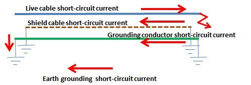

RE: MV cables (IEC)
In my opinion, usually medium voltage system neutral is resistance grounded-500-800 A phase-to-ground
short-circuit current.
The return current resulted from phase-to-earth-to-phase [double-phase grounding] splits in cable shield, grounding conductor and earth itself. Roughly calculating, neglecting the reactance- if the cable screen is of aluminum foil longitudinally applied, the cross-sectional area of 25 mm^2 the resistance will be Rsh=1/35*1000/25=1.14 ohm/km at 20oC, the grounding conductor of 1*300 mm^2 copper Rgrcnd=1/58*1000/300=0.057 ohm/km and Earth grounding resistance will be Rg1+Rg2+0.05 of minimum 1 ohm[Rg1 and Rg2 grounding resistance of both sites] then Rtotal=1/(1/1.14+1/0.057*1)=0.054 ohm/km
The presumable shield current will be:
Ish=Ic*0.054/1.14 and if Ic=40 kA then Ish=1.8 kA.
In my opinion also if the cable construction is as per EDF NFC-33-226 standard the short-circuit withstand capability has to be around 3.2 kA.
