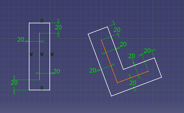

is it possible to create a rectangle or polygon around the selection line use the CATIA macro
RE: is it possible to create a rectangle or polygon around the selection line use the CATIA macro
answer is yes
you have all lines in the selection, check all extremities points then from that create whatever polygon you want.
Thank you itsmyjob!
i have get your idea ever,but I don't know using what code to get the extremities of the all lines.
the line will give you the points, from the points you get XY...
