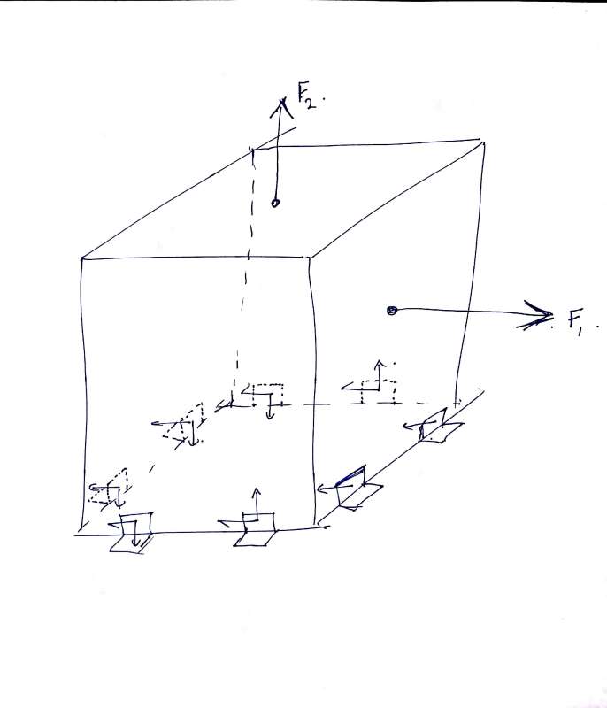

I have a rigid box. It is stuck to the ground with scotch tape at discrete locations around the box. I would like to determine the forces developed at the scotch tape locations when I push and pull on the box with forces F1 and F2.
Assume I know all the geometric information about this experiment. This would include the length, width and height of the box, the relative location of application of the forces F1 and F2 and locations of the scotch tape.
Assume also that the box and ground are fairly rigid with respect to the scotch tape.
What simple analytical method exists to solve a problem like this?
RE: Pushing a box stuck to the ground at discrete locations
If F2 is applied at the centroid of the box / tape arrangement then F2/# of connections.
The shear at the tape would be F1/# of connections that can resist the load (may only be 4 in this case).
The uplift would be F1*distance of force from the ground/ moment arm of connections.

structSU10, a couple of comments:
"If F2 is applied at the centroid of the box / tape arrangement then F2/# of connections."
Sure, that makes sense.
"The shear at the tape would be F1/# of connections that can resist the load (may only be 4 in this case)."
I contest the fact that only 4 connections are activated to resist the load. To me it looks like all of them are resisting the shear load. Could you please provide more basis for the fact that only 4 are activated, and which ones in particular?
"The uplift would be F1*distance of force from the ground/ moment arm of connections."
Does this include all connections or only a few? Please elaborate.
I would be inclined to say only 4 would resist the shear because the tape is flexible and stretchable. So the only ones that would really contribute to the shear resistance would be the 4 that are parallel to the load direction.
For the moment resistance, all pieces of tape would contribute, except the ones on the face of the box where the load is applied.

A general solution is what you're already gotten.
A scientific method involves you getting a box, some scotch tape, and figuring out what happens. A great example of this is the shear question - Like SU10 & jayrod, I suspect that the tape parallel to the load will resist the load, but not the tape perpendicular to the load, but test it!
Regarding the overturning, it will be a combination of the tape acting in tension and the box bearing in compression. How may pieces of tape act will act in tension and the length of the compression zone is up to you, but assuming an elastic distribution, you'll have 4 pieces of tape in tension, and half the perimeter/area in compression, depending on whether or not the box has a bottom and how rigid it is.

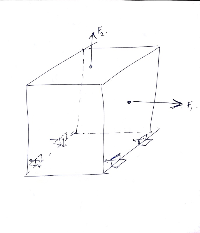

Once2003, The reason structSU10's suggestion is not general can be illustrated by the following modification to the above system:
Say we remove the 4 anchors on the side which supposedly resist shear. If the loads remain the same, what now resists the shear? I guess what I'm getting at by "general solution" is somthing that can give me reactions for any arrangement of "scotch tape" or loading. Thanks...

I think The contribution of the 4 tapes shown left in the 16:31 post are especially troublesome, as it looks like pure peeling from one surface or another. Those would likely quite weak, making the solution of the actual reactions that more difficult.

Allright. The real problem is that I am trying to calculate required loading/stress for HVAC equipment anchorage. F1 and F2 are simply horizontal and vertical components of seismic loading per ASCE 7 chapter 13. I thought I could dumb it down to a simple problem like this because every resource I've seen on the subject talks only about design code requirements but does not provide an answer to the real question: How do we determine the loads on the anchors? We get plenty of stuff on how to determine capacities, etc, but proper structural analysis to determine loading on the anchors? Zero.

I still think that my previous assumption is how I would design the anchorage anyway. Assuming the anchorage is as per you first post I would assume the anchors on the sides parallel to the lateral force resist the shear. And the other anchors resist the uplift from overturning.
Too many variables at play otherwise. It results in overdesigned anchorage but considering the overall project cost, slightly overdesigned anchorage is just a drop in the 5 gallon bucket.

Hey Jayrod, quick question. With the assumptions stated above (ie anchor points not tape), doesn't this reduce down to an internal shear/moment problem? What I mean is a problem requiring the use of internal stress equations like My/I and VQ/It or ones similar to them? The system can be idealized as a "quasi cantilevered" beam with fixed base. The beam is just short and fat like a box.
I got this idea from looking at the following video: https://www.youtube.com/watch?v=YpDEnL8TjrM
The lecturer uses a modified (My/I)+(P/A) equation for discrete points. It is modified as follows:
tension/compression per anchor = (My/(Sum(d^2))+(P/(no anchors))
He does however use a simplification for the resulting shear
Shear per anchor = V/(no anchors)
I don't like this simplification. If we are using analogues to My/I and P/A for moment and axial, should we not also use an analogue to VQ/IT for shear? If so what could this analogue be? the problem would be the thickness to use... since for a beam we use the beam thickness, but for a set of discrete anchor bolts there's no real "thickness" to use, but maybe there is a way to simplify this equation for shear to make the responding shear loads quasi-parabolic (which is what they should be, in my opinion).
