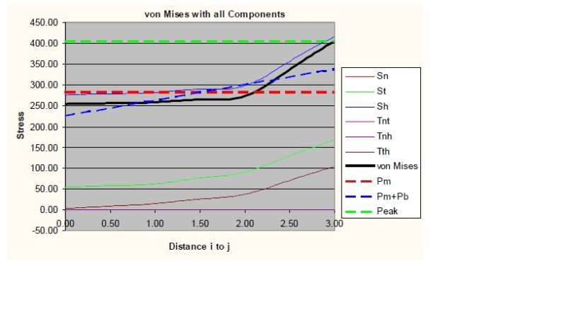

Because, the engineers of PVENG make graphics showing the SCL line at the x axis and for the y axis they show the Pm+Pb stress, for each node of the line, like this image.
So, what means Pm+Pb in the graphic if there is just one Pb.
http://pveng.com/fea-stress-analysis/notes/stress-...
Thanks for your help.
RE: Calculate Pb (bending stress) linearization
That is a graphical representation of a straight line. If you read the text of the article, you will see that there is only one value for Pb.
Yes, they say there is only one value for Pb, but there is one value for Pm too. So, how can I get the graphic where Pb+Pm is not constant, like the image.
As the word linearization implies, you calculate a linear stress distribution that has the same bending moment as the actual stress distribution. The result is a bending stress value Pb that, in your graph above, equals some 60 (MPa?). You have that value at one wall face, minus the same value at the other face and zero at mid thickness. It is hence irrelevant the local value of this (idealized) linear distribution, only the single bending stress Pb at the face has an interest.
