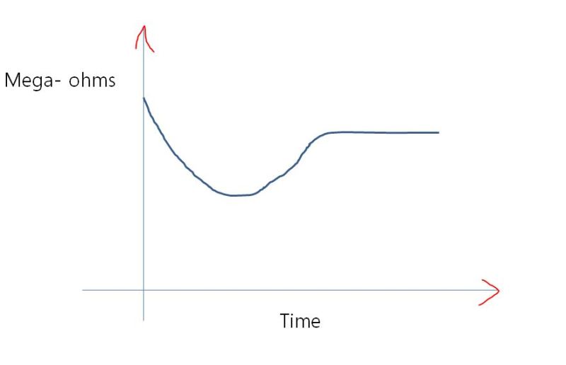

Keeping motor warm : Normally we have 1 year gap between design stage and commissioning stage for offshore vessels , thus before commissioning the motors and generators are being dried out .
-A low voltage 3 phase AC is applied , low enough so that the shaft cannot be rotated or in other words current do not reach to a value which can rotate the shaft.
-The applied current is switched On and Off at regular intervals and the insulation resistance is recorded .
-The insulation resistance decreases initially with rise in temp and continues to fall until a steady temp is reached
-When the machine becomes dry , the insulation resistance comes back high to normal levels.
If you plot a graph it shall become like as shown below .
