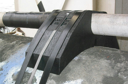

A 42" line-break valve has a 2" sensing line which shall be branched min. 5D downstream in an underground gas pipeline. 2" branch shall be done at 12 o'clock. Is it acceptable (from engineering point of view)to use sandbags under 2" pipe (as it is shown in the below picture) permanently and backfill the line?

If this was me I would make the small pipe vertical, encase it in a PE or similar pipe about 3 pipe sizes bigger and fill the annulus with pea gravel. I would also consider making the connection 100mm then reducing t0 50mm to give the connection some strength. Those two 90 degree elbows could easily become overstressed with even a small amount of compaction or "leakage" of the sand bags
In answer to the original question, No, it's not acceptable for all the reasons given above. If you have to do it this way then piggyback it using proper blocks like they do subsea, probably at about 500mm centres.

your clamp as shown is even worse than a sandbag as it provides a concentrated point load. The piggyback clamps shown in the post above would need to be nearly continuous in this instance to provide sufficient support to that rather weedy little line.
