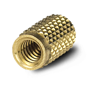

RE: Conection between two plastic parts
Jam one of these in the plastic and screw in the cables. If the ferrule is sized properly and the plastic is right, those puppies aren't coming out.
Dan - Owner
http://www.Hi-TecDesigns.com
