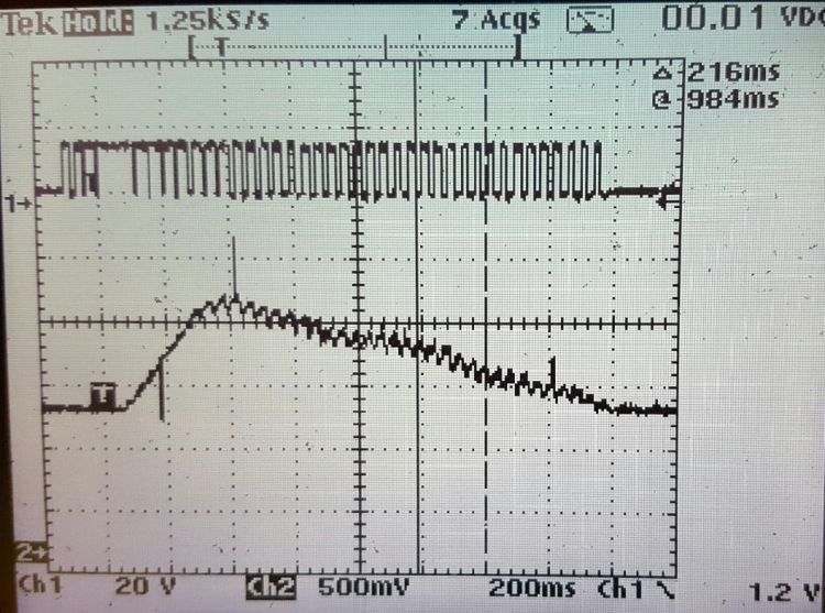

Went on to replace the EGR valve after much thought and dragging a scope out and watching the EGR and the PWM running into the EGR solenoid. Installed the new EGR and it worked... worst yet.
Here's an interesting shot of the PWM (top) controlling the EGR solenoid which supplies vacuum to open the EGR valve.
The bottom trace is the analog pot built into the EGR valve to feedback the amount of opening to the engine control computer, ECM. This actually looked ok but I had the feeling the EGR valve was way out of calibration and opening way too much with way too little vacuum. I suspect I was correct because the new EGR valve made the engine run considerably worst. :/

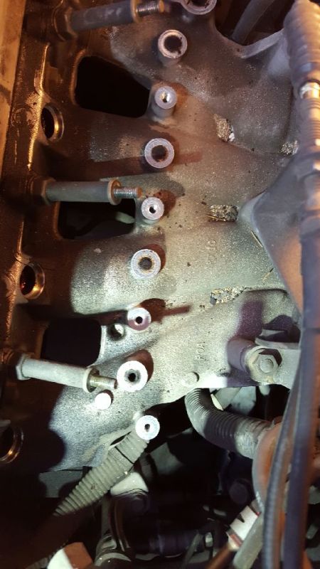

So I finally decided to eliminate the clogged EGR runners possibility. I'd been dreading it because it looked like at least 4 or 5 hours of work involving fuel messes etc. Watched a YouTube video of a mechanic doing exactly the same car. !! Easy. You pull just a few vacuum lines (4), unbolt a solenoid, pull three 10mm nuts, and pull the entire 'fuel log' which includes all the injectors out at once and bend it up vertically with all fuel lines intact. This means you never even open the fuel system.
Once the log is out you're looking straight down on the EGR runner manifold which comes off with 5 10mm bolts. Got my returned daughter scraping out the galleys and then dug out the orifices.
Note the four holes next to the bolt holes? The top three were completely blocked. This left only the bottom hole open. When the EGR valve opened it sent ALL the recirculated exhaust into one single cylinder. Hence, the steady miss.
Took about 35 minutes..
As soon as we started it it ran smoothly with no missing what-so-ever. Mission accomplished.

Thanks...Interesting in that I read a few online discussions about clogged EGR paths and it was only after reading YOUR explaination did it make sense.
so it is not the plugging of the paths BUT the non uniform plugging.
RE: Fun with a 4 cylinder engine.
Car wiring; Blech. I hear you there David.
byrdi; I actually learned that as the ports clog the engine starts to run poorly. As they clog it runs worse and worse until they all clog then the car runs great! It just fails smog testing. :/
