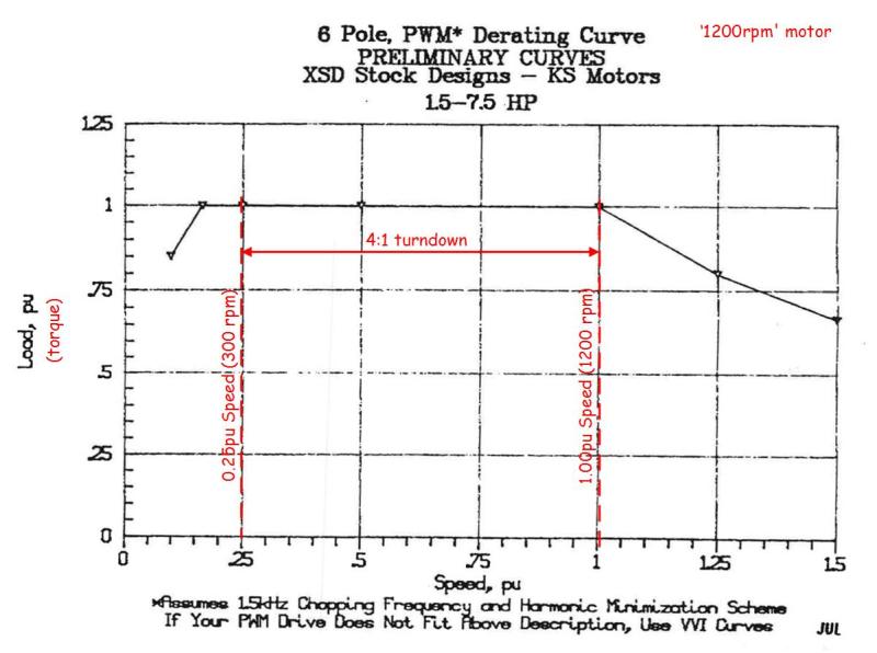

Hi Azif,
Please find below, a typical Speed-Torque capabilities curve for a 3hp induction motor. This curve is based on a GE 4-pole (ie 1800rpm) motor under PWM type control. This curve is 25 years old, but your motor OEM should be able to provide a similar curve. With this motor your can achieve a (almost) 10:1 turn-down, with a derate of 25% motor torque.
This implies that the mechanical turndown required is now 50:1 (ie 250/5). This can easily be accomplished via a belt drive and gear-box combination.
I am curios however in that you stated above that 'The minimum auger rpm is 5-10 rpm'. What is the max rpm that you require? The scheme below can provide a maximum auger speed of approx 50rpm (assuming a mechanical turndown of 50:1).
I have successfully used this scheme many times on constant-torque applications much-much larger than 3hp.

RE: Variable frequency drive
Hi Asif,
No, the above graph illustrates that, with this particular motor, you can achieve a 10:1 turndown with the motor alone.( ie this motor can provide 75% NP torque from 250rpm thru 2430rpm.)
Now that I know that your auger speed is 5 to 20 rpm (ie a 4:1 turndown), please find the curves below for both a 4-pole (1800rpm) motor and a 6-pole (1200rpm) motor.
Note,
1) Either of these options will work fine, although I prefer the 6-pole option as it has a lower bottom end speed. (ie less onerous requirements for the mechanical speed reduction hardware).
2) There is no motor derate for either the 4-pole or 6-pole option (in the case of these particular GE motors).
3) You should obtain similar derate curves from your motor OEM. I wouldn't think that they will be much different from the curves below, but I would still confirm.
4) I suspect that the mechanical turndown hardware will consist of a belt-drive and gear box, with an overall turndown of:
- 90:1 for the 4-pole option, or
- 60:1 for the 6-pole option

Hi Azif,
I apologize for taking so long to get back to you, but occasionally I need to do some work. Bosses are funny that way.bigsmile
The intent of the curves, that I attached above, was to illustrate the turn-down ratio that an typical induction motor can provide without over-heating.
From the above curves, most motors driving a constant-torque load, can provide a 4:1 turndown without having to derate the motor or having to supplying an external blower fan. With a derate of 25% on a (6-pole) motor, a turndown of 10:1 can be achieved, again without an external blower fan. A turndown of > 10:1 will require either further derating or a blower fan.
