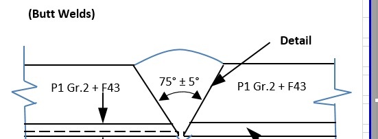

Hi Expert,
Is there anybody can explain Longitudinal Crack observed on SAW Process with ERNiCrMo-3 ?
Is it because hot cracking by austenitic weldment, weld shape (Weld/Depth),segregation or flux ?
In this case I want to joint pipe to pipe (X65) with Clad 625 inside, there is no option , we have to use SAW process for this joint.
Your advise and knowledge would be meaningful
Thanks and Regard's

So the root weld is strictly 625 to 625 with the steel striped back.
And they you are building up the steel over that, with what filler?
Pictures would help a lot. and a sketch also.

Is the longitudinal crack in the NiCrMo-3 pass adjacent to the X65 HAZ or in the center of the weld? Where does the hot crack initiate - in root or somewhere else in the trough thickness? What is the bevel angle?
I have seen this weld made successfully numerous times without cracking; root pass with GTAW and fill with SAW in the shop. How are you making the root pass - not with SAW I should think.

I could see using TIG to weld the 625 root pass and then SAW to fill the outer pass.
You will not be able to weld the full wall in a single pass.
Mixing the 625 and the steel will result in poor corrosion resistance (why the 625 is there to begin with), undefined (or mixed structure), dubious properties, and poor weldability.

So you are making the fill pass with a single pass? If so, I would recommend multiple passes to be used. I have made this weld successfully with multiple weld fill passes. You may also wish to open up the included angle to 90 degrees.
You still haven't defined the flux used and the crack location.
RE: Hot Crack (Longitudinal Crack) SAW Process with ERNiCrMo-3 Filler
And I would suggest that put a step into the groove to cut back the steel a little so that the first pass is only 625.
Agree with weldstan. Multiple pass and increase the included angle.
