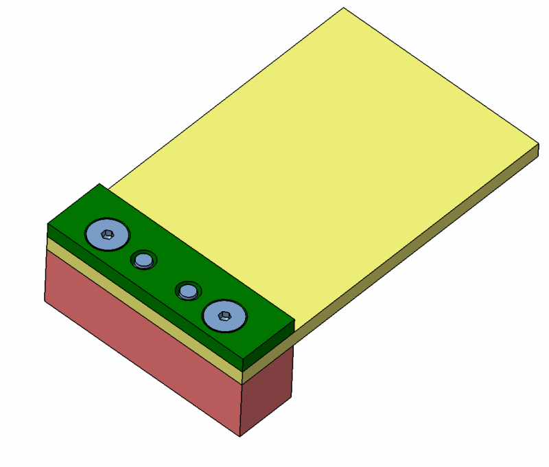

Hi there,

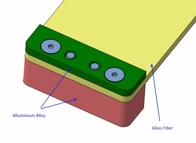

We are building some supporting plates made of G10 (FR4) due to its good mechanical properties and low thermal conductivity.
It is the first time we design something made of glass fiber and we have some concerns.

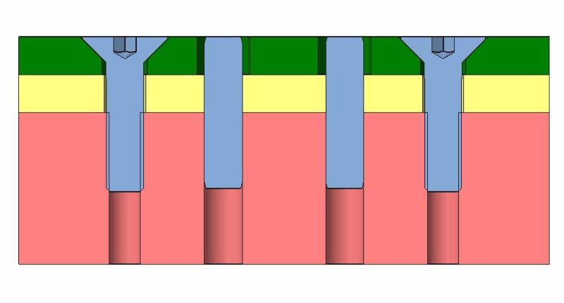

We managed to design the plates without making threads on the G10. On one side we will glue it and on the other side we will screw it to another threaded aluminiuim alloy part part.

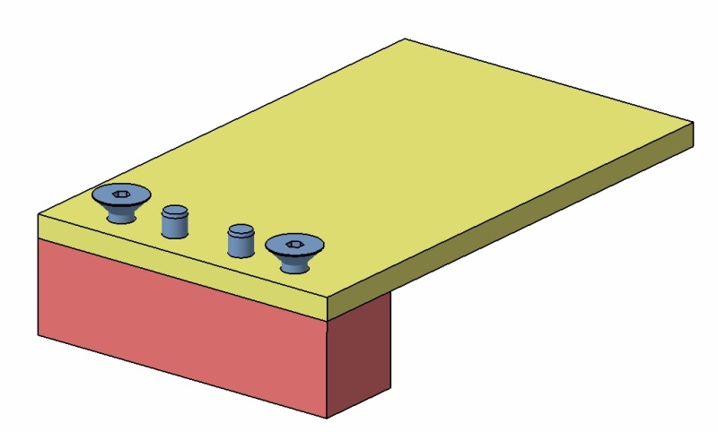

For this second side we need to press the G10 with the screws head. I am concerned about breaking/damaging the fibers with the screw head.
Attached some pictures showing the setup. We use conical head screws to save space (we might find space for flat head and washers).
There are 2 positioning pins and two screws. Are positioning pins reliable on G10?
I have heard something about putting in some bushings, but I understand the bushing will press the fibers too.
How could we connect the plate?
thank you

Can you use a clamp bar across the top side, which would work as a washer under the screw heads? A metal bushing increases the contact area and reduces the bearing stress on the composite. Composites do not handle dowel pins well. It is very easy to delaminate the composite when installing pins.
RE: Crushed glass fibers by joining screw
Dowel pins are not a problem if they are not a press fit, and bearing stresses are not excessive. Flush head fasteners should be fine - they are used all the time in aircraft glass and carbon fiber composites.
The dowel pins would have a fitting of H7/j6 or h6. Not so tight. We are concerned about the bearing stress of the fibers "behind" the hole. The forces will be held by the resin in shear.
The bar on the top is a good idea, but then all the force will be taken by the friction on the touches surfaces on the plates because of the screws. No shear.
Something like this (bar on the top in green, no adjustment with the positioning pins:
I think that looks much better. If your loads are significant, it would also be a good idea to radius the square edges on the support and clamp bars. A square knife edge would tend to cut into the composite part due to high bearing load.

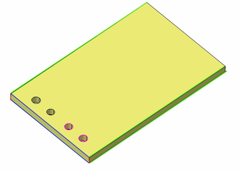

Compositero,
Which edges do you mean? the rectangle corners? Attached some pictures.

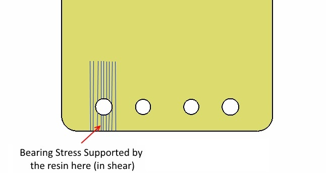

We have 50Mpa on the pins/screws area.
According to Matweb, the G10 has a Tensile Strength at Break of 262MPa in the direction across the fibers.
I understand the bearing stress is supported by the resin in shear (direction across the fibers). Picture attached
For the shearing I divide the 262 Mpa by the square root of 3 (von Misses) and I get 151Mpa. Can a resin bear 151Mpa??
I am referring to where the cantilevered composite enters the clamp. If the cantilevered part flexes the bearing forces will be on a knife edge. Ideally, the edge should have a radius the matches the radius of flexture, but any radius is better than none. Your design is very similar to that of the support for a vibratory conveyor, where a set of composites plates support the conveyor but have to flex in order for the conveyor through to vibrate.

drodrig -
1) composites are not isotropic materials,
2) you cannot in any way use a tensile strength to estimate bearing strength
3) the tensile strength is largely driven by the fibers
4) the resin strength is significantly less
5) I thought G10 laminates use a fabric weave, not a unidirectional fiber layup. If it only has uni fibers, then it is the wrong material for parts with holes; you want a material with at least fibers in two directions such as warp and fill in a fabric; better yet to have fibers in 0, +45, -45, 90 degree directions.

Compositero,
I've read your message sereral times, but I still don't understand which edges you mean. I am not English native speaker and I get lost. Which edge do you mean? Here a picture with different colours (red, blue, green and pink)

The edges I mean are on the metal parts in contact with, and clamping, the composite part, not the composite part.

Ahá! radius on the metal parts! thanks I understand now the knife effect.

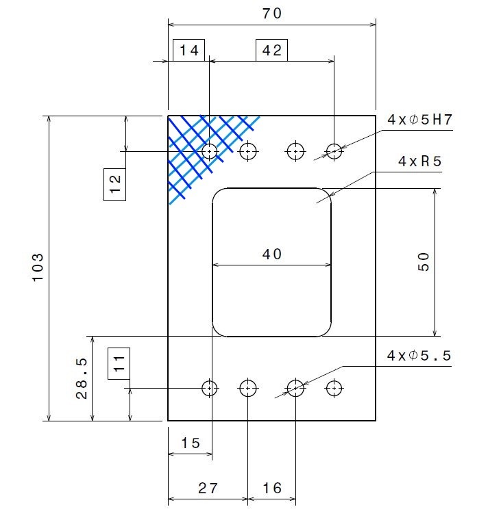

Hi again,
Just a last question.
We are going to order some testing parts of the plates. I asked a couple of companies and the material is only available in 0/90º directions.
I thought we can "rotate" the part 45º so the fibers "behind" the holes next to the border aren't completely cut.
Here, with blue lines, the idea:
What do you think about orientating the part so the fibers go at +/-45º?

The flexural stiffness will be lower and damping will be greater.
Why lower?
actually in the case of +/-45º I have the square root of 2 bigger along the long side axis.
and the situation with the holes close to the border should improve, shouldn't it?
cheers,
Because fibers are 100 times stiffer than resin. Continuous 0 degree fibers can transfer load from one end to the other with the resin providing only support against buckling. With 45 degree fibers much of the load travels through the resin and transfers fiber to fiber by shear loading. Also fiber will scissor. The difference is quite dramatic.

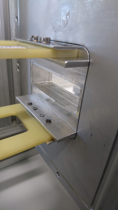

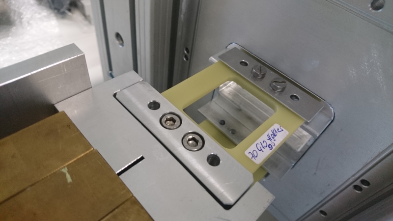

We have our first loading test mounted.
Here some pictures.
The glass fiber plates (in yellow) are pressed on both sides by aluminiums parts. When I was screwing the parts I was wondering how much I should tighten. Is there any rule of thumb?
I though that we could use some soft material (foam, tissue...) in between the glass fiber plates and the aluminium. Would you recommend that?
thank you in advance
It probably is not a problem but, the location of your clamping screws relative to the flexing composite bars looks "odd" to me. You basically have cantelevered clamping bars that are at 90 degrees to the flexing bars. This will result in a higher clamping load on one side of the flexing bar and a very complex load pattern.
Also the thickness of the clamping bar relative to the flex bar seems low, particularly since it is cantelevered. Flexing of the clamping bar means movement and therefore fretting.
