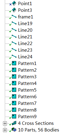

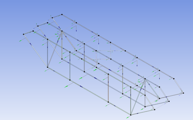

i want to copy this structre by using the pattern.

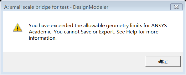

But it occured this problem.
how do i fix it ?
It should be point out that i need to copy the number of 400 of this structure !!!

You can not fix it. The model size in the Academic Version is limited to prevent its use for commercial purposes.
