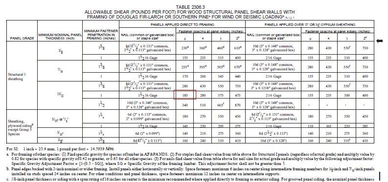

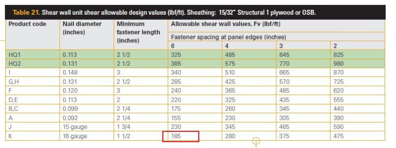

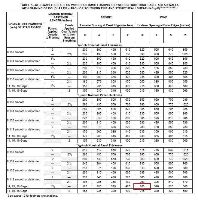

The following tables are taken from ESR-1539, Bostitch and IBC, respectively.
How can i justify using the ESR-1539 which (apparently) has an allowable 260 PLF, while Bostitch and IBC list an allowable 185.
What am i misunderstanding?
Thank you!
RE: 16 Gage Staples
See IBC2306.3 - You can increase the IBC values by 40% for wind design. The ESR just lists the wind and seismic separately similar to NDS and includes the extra 40% in the table.
